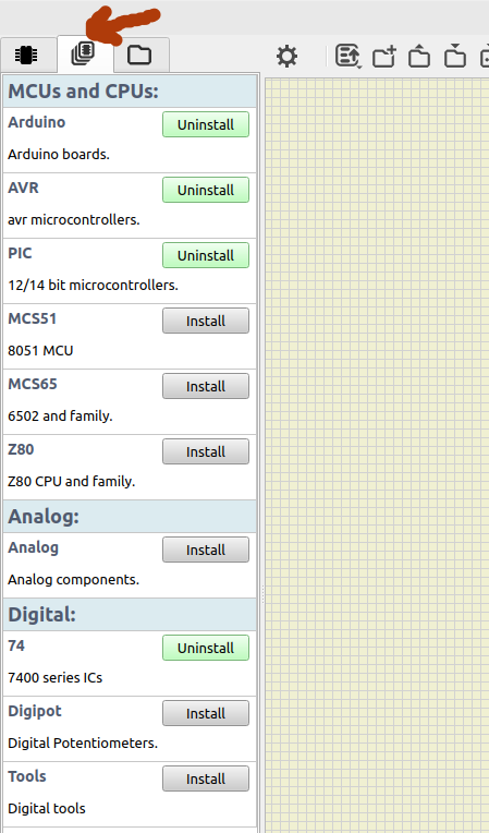

74XX ICs and CD4XXX ICs are not included in 2.0.0 because is quite outdated, there is a new 7400 set optimized for this version.
You can use files from previous versions, but the default option is to install from simulide GUI:
This way you can update if there is some change:

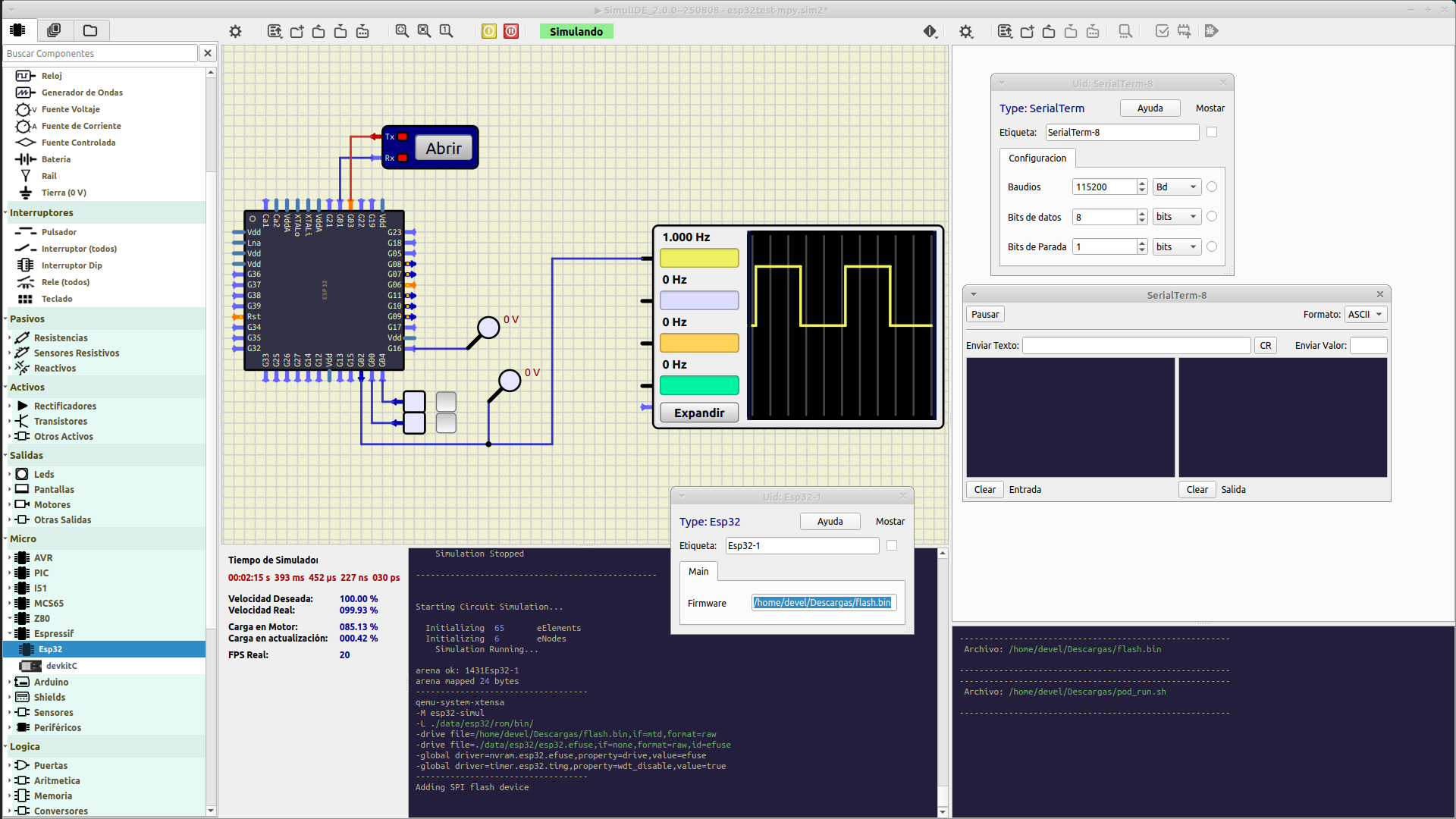

Quote from acebrian on November 16, 2025, 2:54 pmI have been testing the experimental support for the ESP32 (GPIO and I2C only).
I think adding the option to work with MicroPython on the ESP32 in SimulIDE could be interesting.
I can confirm that the QEMU being used does support it:
1) Create the MicroPython image:
dd if=/dev/zero bs=1M count=4 | tr "\000" "\377" > flash.bindd if=ESP32_GENERIC-20250911-v1.26.1.bin of=flash.bin bs=1K seek=4 conv=notrunc2) Run the MicroPython image with QEMU, adding the serial console:
./data/esp32/qemu-system-xtensa 1431Esp32-1 qemu-system-xtensa \-M esp32-simul \-L ./data/esp32/rom/bin/ \-drive file=../flash.bin,if=mtd,format=raw \-drive file=./data/esp32/esp32.efuse,if=none,format=raw,id=efuse \-global driver=nvram.esp32.efuse,property=drive,value=efuse \-global driver=timer.esp32.timg,property=wdt_disable,value=true \-serial stdioarena ok: 1431Esp32-1

>>>3) Run a MicroPython sample program (led toggle):
>>> import umachine, utime>>> led = umachine.Pin(2, umachine.Pin.OUT)>>> while True:... print("o", end="")... led.toggle()... utime.sleep_ms(500)...oooooooooooooooooooooooooooooooooooooooo4) Save the MicroPython sample program as "boot.py" in the image so it runs automatically:
content = """import umachine, utimeled = umachine.Pin(2, umachine.Pin.OUT)while True:print("o", end="")led.toggle()utime.sleep_ms(500)"""
with open("boot.py", "w") as f:f.write(content)5) Test the final MicroPython image with SimulIDE:
Led toggle (GPIO) works as expected. I also tried connecting the UART0 pins to a Serial Terminal but, logically, it does not work.
The QEMU serial console would need to be redirected to SimulIDE in order to interact with MicroPython.I also tried doing the same with the "devkitC", but I cannot find where to configure the firmware file that should be loaded:
./data/esp32/qemu-system-xtensa 1431Esp32-1 qemu-system-xtensa \ -M esp32-simul \ -L ./data/esp32/rom/bin/ \ -drive file=../flash.bin,if=mtd,format=raw \ -drive file=./data/esp32/esp32.efuse,if=none,format=raw,id=efuse \ -global driver=nvram.esp32.efuse,property=drive,value=efuse \ -global driver=timer.esp32.timg,property=wdt_disable,value=true \ -serial stdio
Best regards.

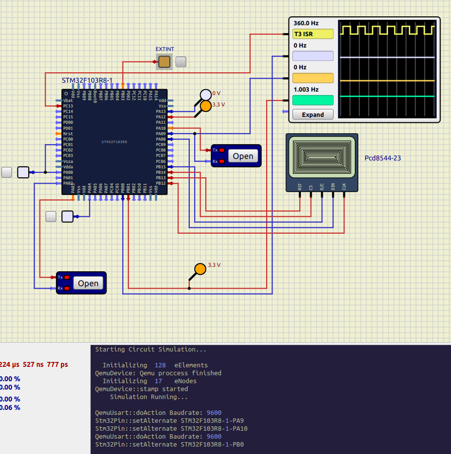

I have been working to implement Qemu STM32 inerface to SimulIDE, as it seems simpler to me than Esp32.
Now I'm taking a break because my brain hurts trying to understand Qemu, but I got most important peripherals more or less working. Still very raw but as a proof of concept is ok.
- GPIOs, with Remap and Pin change interrupts.
- Some Timers, with PWM, input capture, some Interrupts.
- UART, send and receive, some interrupts.
- TWI, send and receive.
- SPI, send and receive.
Esp32 was synchronized with SimulIDE only one way, SimulIDE could not send events to Qemu.
Now 2 way synchronization is implemented, which allow for Pin change Interrupts, Timer Input capture, UART receive, etc.
I still have to port these changes to Esp32, but the framework is more or less working.

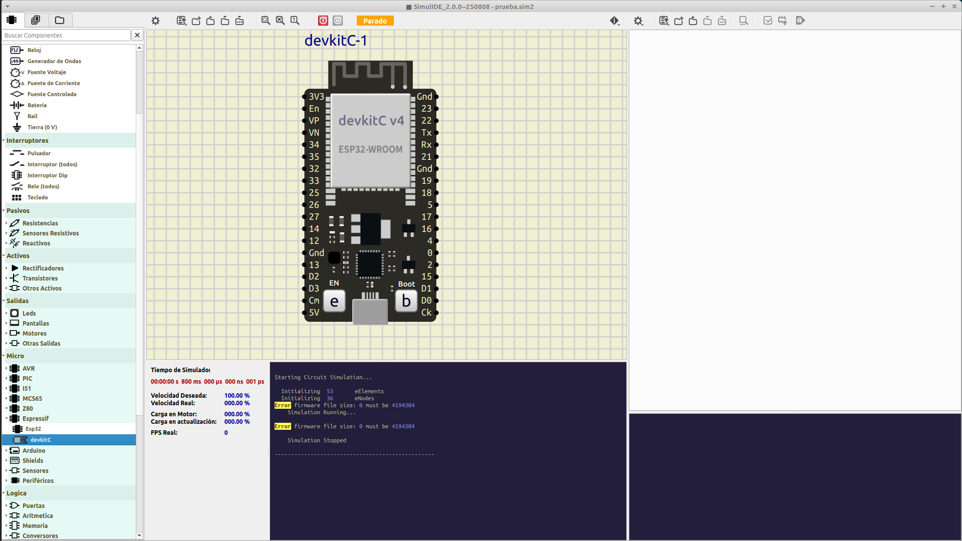

Quote from arcachofo on April 7, 2026, 11:05 amHi guys.
New tester build for SimulIDE 2 available for download: https://simulide.com/p/testers/
There is an experimental implementation of Esp32.
Should be working (at least partially): GPIO, SPI, I2C, Uart, Wifi, LED PWM, Timers.There is a circuit example included.
Any reports are very welcome.
Hi guys.
