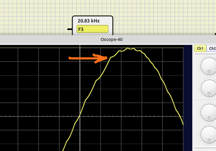

Quote from arcachofo on November 26, 2024, 12:31 pmSuch distortion doesn’t exist in real. I mean that the scope of simulIDE is ok for the low band only because the delta bit rate is 62,500 Hz, not 2,000,000 Hz (of the high band).
The Oscilloscope should be ok upto hundreds of GHz.
I think it is only showing what is happening in the simulation.Maybe you should have a look at "Reactive Step" for those capacitors:
https://simulide.com/p/reactive-components/

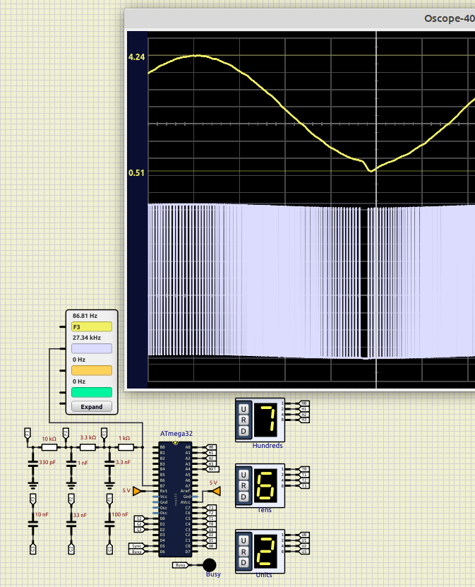

Quote from KerimF on November 27, 2024, 11:59 amQuote from arcachofo on November 27, 2024, 8:11 amNice project.
Is this the distortion you mentioned?
No.
The distortion I was referring to occurs at some low frequencies (low band). It occurs at the negative peak only.
I found now some of these frequencies. Their indexes are:
762, 752, 772, 683 and 685.
The worst one is of 762 (attached)

Quote from KerimF on November 27, 2024, 2:38 pmI will check the bits of this stream (stored in SRAM) on Excel to see if it is also missing a pulse or more.
And I think it is time for me to check each frequency on a real board too.
Thank you.
Thank you.
Quote from KerimF on November 27, 2024, 3:18 pmIt seems that the generated stream in SRAM is ok. But perhaps there is still a hidden bug in the wave loop that reads its bits.
I will have a look.
I also attached the bits per cycle of each index (and the frequency), DSS_Bits_Frequencies_v1.zip.
I will have a look.
Quote from KerimF on November 27, 2024, 6:02 pmI attached the Excel sheet of index 762, SinePlot_DSS_762_v1.zip
The bytes at the cells T53, T54 and T55 (dark orange color) give the 17 consecutive 0’s. See also the cells of 0's at P365 to P381.
These 0’s are actually at the zero crossing of the sinewave (negative slope). But the 3-RC LPF shifts its phase.
