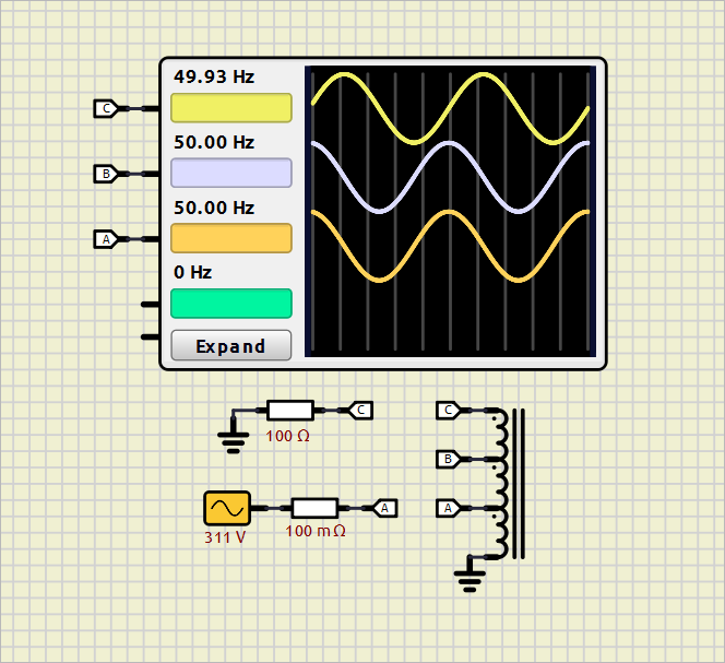

I tried to simulate a circuit which has a transformer having three coils in series. Their turns are 93, 32 and 53 respectively.
I surely miss something on the schematic since the voltages on its upper two terminals B and C are wrong.
Thank you.

Quote from KerimF on January 30, 2024, 8:52 amQuote from arcachofo on January 29, 2024, 3:29 pmHi.
Which voltages do you expect?Hi,
The turns are:
93 from ground to A
32 from A to B
53 from B to CIf V(A) =311 (220 Vrms), I expected (as Vpeak):
V(B) = 311 * (93+32)/93 = 418 V
V(C) = 311 * (93+32+53)/93 = 595 VOn my side, I got:

Quote from arcachofo on January 30, 2024, 3:22 pmAs I see in the configuration for the transformer, turns are 92,32,53:
C-B = 92
B-A = 32
A-GND = 53And (C) is connected to ground through a 100 Ohm resistor, so the voltage here is expected to be very low.
The turns are:
93 from ground to A
32 from A to B
53 from B to CTo get the values you expect yo should use:
-Transformer: Primary = 53,32,93
-Disconnect (C) from ground.
I see a potential problem with transformers:
If the component is rotated then then the order could be different.
Same if it is flipped for Primary/Secondary.
We need some kind of marker for the first coil and also for Primary/Secondary.

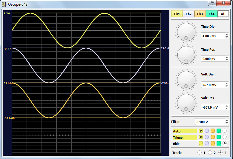

Quote from KerimF on January 30, 2024, 4:50 pmQuote from arcachofo on January 30, 2024, 3:22 pmAs I see in the configuration for the transformer, turns are 92,32,53:
C-B = 92
B-A = 32
To get the values you expect you should use:
I followed what you said and the voltages at (A), (B) and (C) became as expected after disconnecting (C) from ground.
For the time being in the least, re-organizing the values of turns to get the right voltages could be done whenever necessary.
For instance, I guess the transformer model is of an ideal one in which its basic formulas could be applied:
V2 / V1 = N2 / N1 = I1 / I2
So, I expect, after removing the 100mR, and adjusting the transformer turns, the current in the 100R is 5.95 A, while the current at terminal A is:
(voltages and currents are peak ones)
Ia = 5.95 A * 595 V / 311 V ~= 11.4 A
The 100R is simply an arbitrary load. There is always a certain load, if not loads (one at each terminal) connected to a transformer.
Only now, I noticed that the coupling coefficient (K) cannot be set to 1 (it returns to 0.9999). So, increasing the base inductance (to 10 H, as I did) increases the series leakage inductances as well and the drops of the output voltages increases too (for the same load).
I think I will have to revise the formula which relates K and the leakage/magnetizing inductances to also find out, for example, the expected drop at (C) if loaded with 100R.
