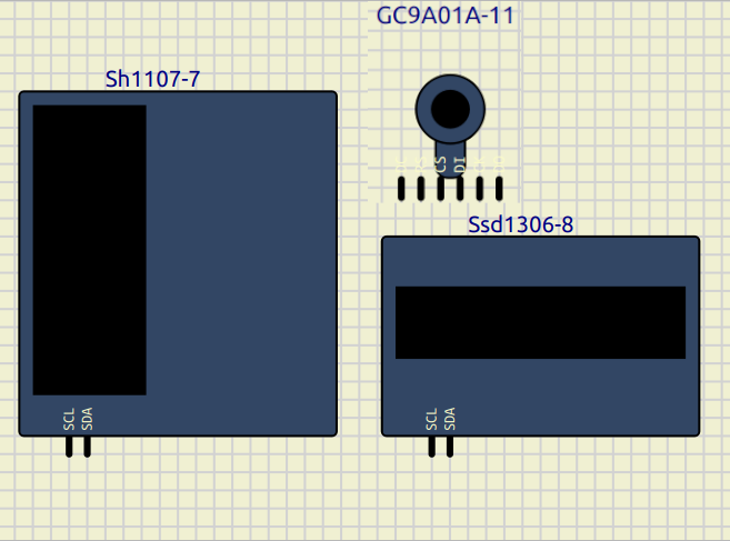

I'm trying the latest version from GitHub 2.0.0. The new displays are beautiful, I've only noticed some issues with resizing from the properties. Here's an image:

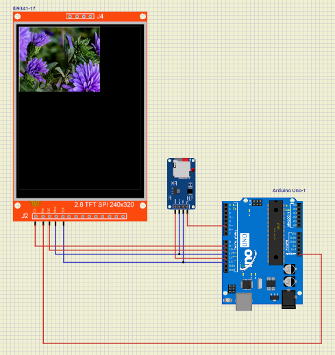

I tried some sketches with SD card and some work but others give an error in initializing the board, while in the SimulideArduino version the board is seen, I attach the sketches and an image:

Hi. Thanks for reporting.
Yes, there are still many details to fix.
I fixed this one and commited.
This is a different implementation than Picsimlab.
I found some issues and ended implementing it almost from scratch.
Multiple block write is not yet implemented, I think it should work easily but I'm a bit saturated about SD protocol right now, I will do it some day soon.
Thanks for the example, I will use it for testing.

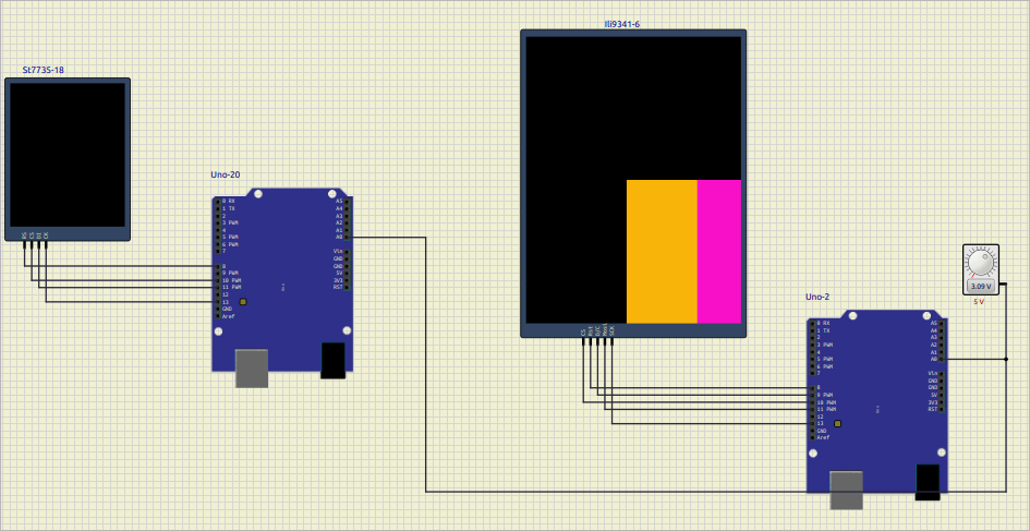

I think the ST7735 display is missing the D/C pin, here is the picture with ST7735 and ILI9341 with the same sketch only ILI9341 works of course with 128x160 resolution:
This one is using 3-line serial interface, probably I will make it configurable.

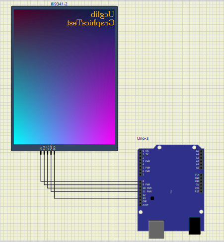

I noticed a difference between the old ILI9341 and the current one using the same sketch.
I'm attaching images.
Regards

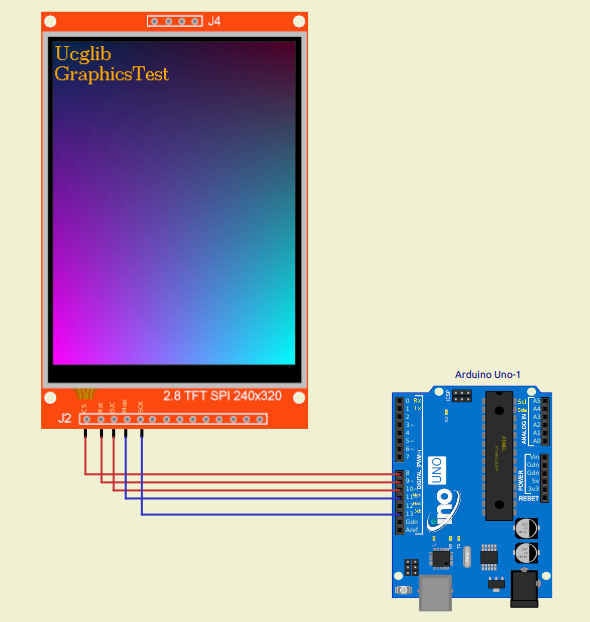

With the "Adafruit" libraries it works well while with the "Ucglib" libraries the image is mirrored, I attach a sketch:
I think the problem is in the "getPixel" function, if I change it as in previous versions it is not mirrored:
        for( int col=0; col<m_width; ++col )
            //uint32_t pixel = getPixel( col, row );
            uint pixel = m_DDRAM[col][row];
            painter.fillRect( col*2, y, 2, 2, QColor(pixel).rgb() );

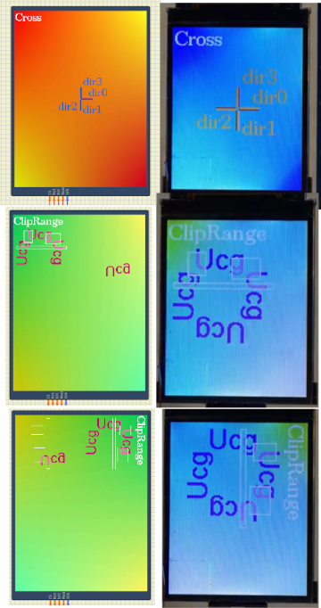

There are still some small display errors as per the images:

I think the mirror issue is solved in last commit.
