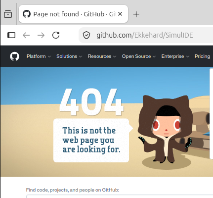

Quote from arcachofo on July 29, 2026, 9:46 amHi.
Thanks for sharing, but seems that the repo https://github.com/Ekkehard/SimulIDE does not exist (or is private?).
