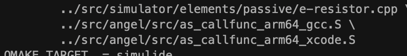

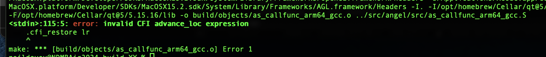

Quote from ndavey on February 1, 2025, 10:59 amHi, just got back to this.. I commented out brackets line you mentioned, this added to .S files to the makefile:
Run through build till it hits the .S file:
Have not found a solution for this yet.. but not spent a lot of time on it yet either..

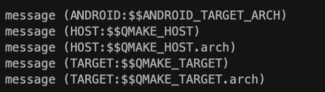

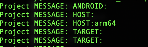

As an aside, I found some code to test in the .pri file:
Result is below, that shows QMAKE_TARGET.arch should be changed to QMAKE_HOST.arch for the contain to work:
Quote from arcachofo on February 1, 2025, 2:03 pmOk, thanks.
I think for MacOs we should avoid to compile as_callfunc_arm_gcc.S
So to test it you could try changing this:SOURCES += $$files( $$PWD/src/angel/src/*.S, true )
By this:
SOURCES += $$PWD/src/angel/src/as_callfunc_arm64_xcode.S
If this works then we will see how to integrate properly in pro file.
Ok, thanks.
By this:

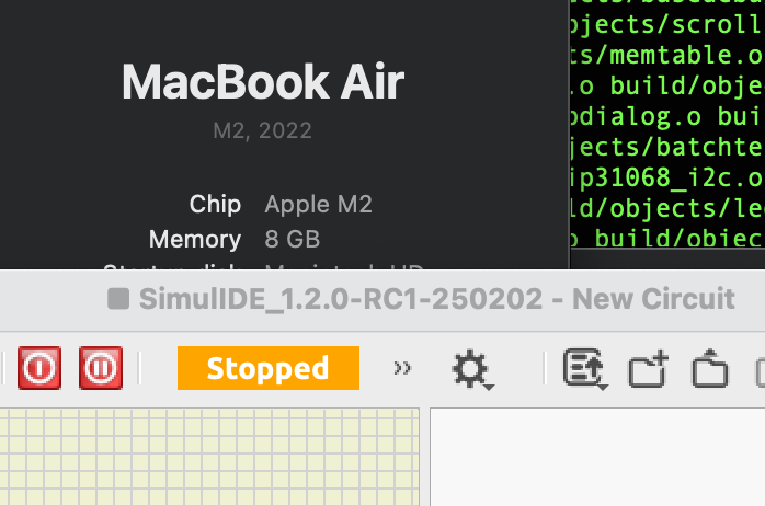

Quote from ndavey on February 2, 2025, 8:17 amProgress... Build completed.. did get this warning:
ld: warning: object file (SimulIDE/SimulIDE-dev/build_XX/build/objects/as_callfunc_arm64_xcode.o) was built for newer 'macOS' version (11.0) than being linked (10.13)but it loads up:
now to run some of the examples (copied them mac x86 version)..
Is there any specific tests you run on builds?
but it loads up:

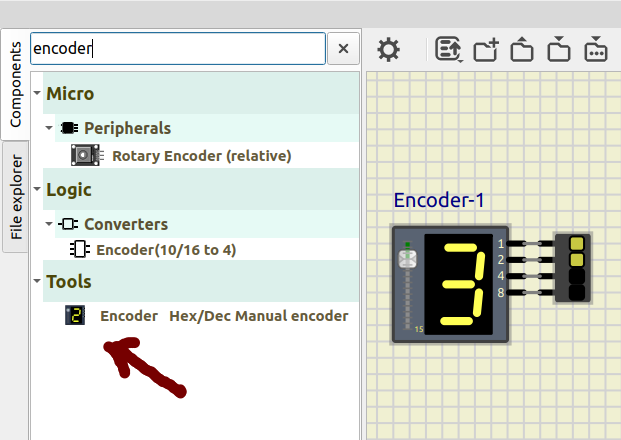

Quote from arcachofo on February 2, 2025, 10:54 pmAlmost missed this...
Glad to know you managed to build it!
Now I have to change the project file to (hopefully) make it work for Mac Mx and Linux arm.About testing:
In this case you can try testing this Encoder, it can be in other category for you.
It comes embedded but it contains an script, so we can see if AngelScript is working:

Quote from ndavey on February 5, 2025, 10:20 amSetup the encoder and LED.. it runs, I can change the slider and the LED's change to match, but the yellow digit on the encoder itself does not change/update:
