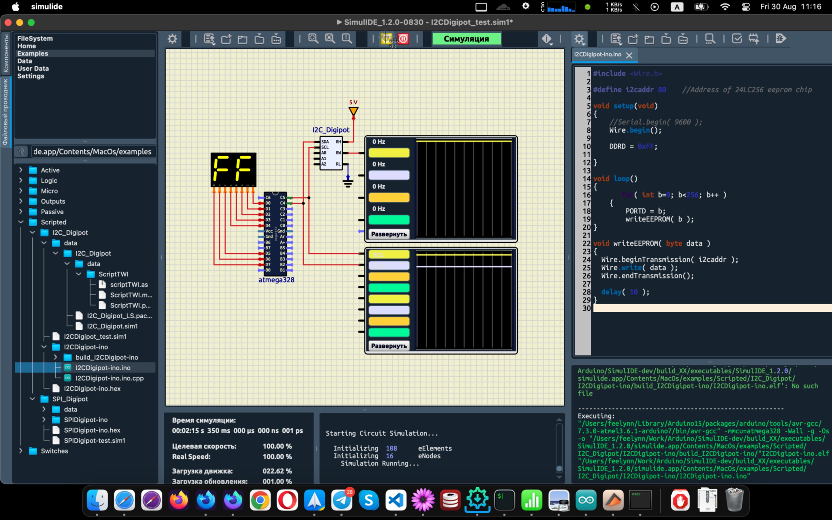

Quote from FeeLynn on September 1, 2024, 12:25 pmHi guys,
Today we will fix Arduino sketch "Compile" button, which is not working in MacOS. (Win & Lin are ok).
It took a bit of time to understand tricky thing: there are two different ways to build under OsX, and both are not working out-of-box 🙂 First one using arduino-cli (brew install arduino-cli
) and second calling Arduino IDE toolchain directly (/data/codeeditor/compilers/compiler/arduino.xml
) - Tricky but powerful. So... Easy First.
1. Init CLI settings:arduino-cli config init
- this will create~/Library/Arduino15/arduino-cli.yaml
where some things supposed to be defined.
2. Add your IDE Library path:arduino-cli config set directories.data ~/Library/Arduino15
3. Modify src/gui/editorwidget/debuggers/inodebugger.cpp:188#ifndef __APPLE__
builder = findFile( path+"resources/app/", builder );
#else
builder = findFile( path + "/" , builder );
#endif
4. Open your .ino sketch and press Gear icon at left, then chooseFile Settings -> Compiler -> Arduino
5. Under same gear chooseCompiler Settings
Set Tool Path to/opt/homebrew/bin/
(M1) or/usr/local/bin/
(x86), runwhereis arduino-cli
if not sure.
Set Custom Library Path to~/Library/Arduino15/libraries/
Set Board:Uno
(your sketch board)
Set Include Path to~/Library/Arduino15/packages/arduino/hardware/avr/1.8.6/
Set Device toatmega328p
and close settings. They will be stored inLibrary/Application Support/simulide/simulide.ini
and your project.That's all, folks. Click "Compile" and "Upload" buttons.
P.S. If you encounter errors with~
symbol - replace it with your home dir path.
Happy simming !
Hi guys,
1. Init CLI settings: arduino-cli config init
- this will create ~/Library/Arduino15/arduino-cli.yaml
2. Add your IDE Library path: arduino-cli config set directories.data ~/Library/Arduino15
#else
#endif
4. Open your .ino sketch and press Gear icon at left, then choose File Settings -> Compiler -> Arduino
5. Under same gear choose Compiler Settings
Set Tool Path to /opt/homebrew/bin/
(M1) or /usr/local/bin/
(x86), run whereis arduino-cli
if not sure.
Set Custom Library Path to ~/Library/Arduino15/libraries/
Set Board: Uno
(your sketch board)
Set Include Path to ~/Library/Arduino15/packages/arduino/hardware/avr/1.8.6/
Set Device to atmega328p
and close settings. They will be stored in Library/Application Support/simulide/simulide.ini
and your project.
P.S. If you encounter errors with ~
Happy simming !
