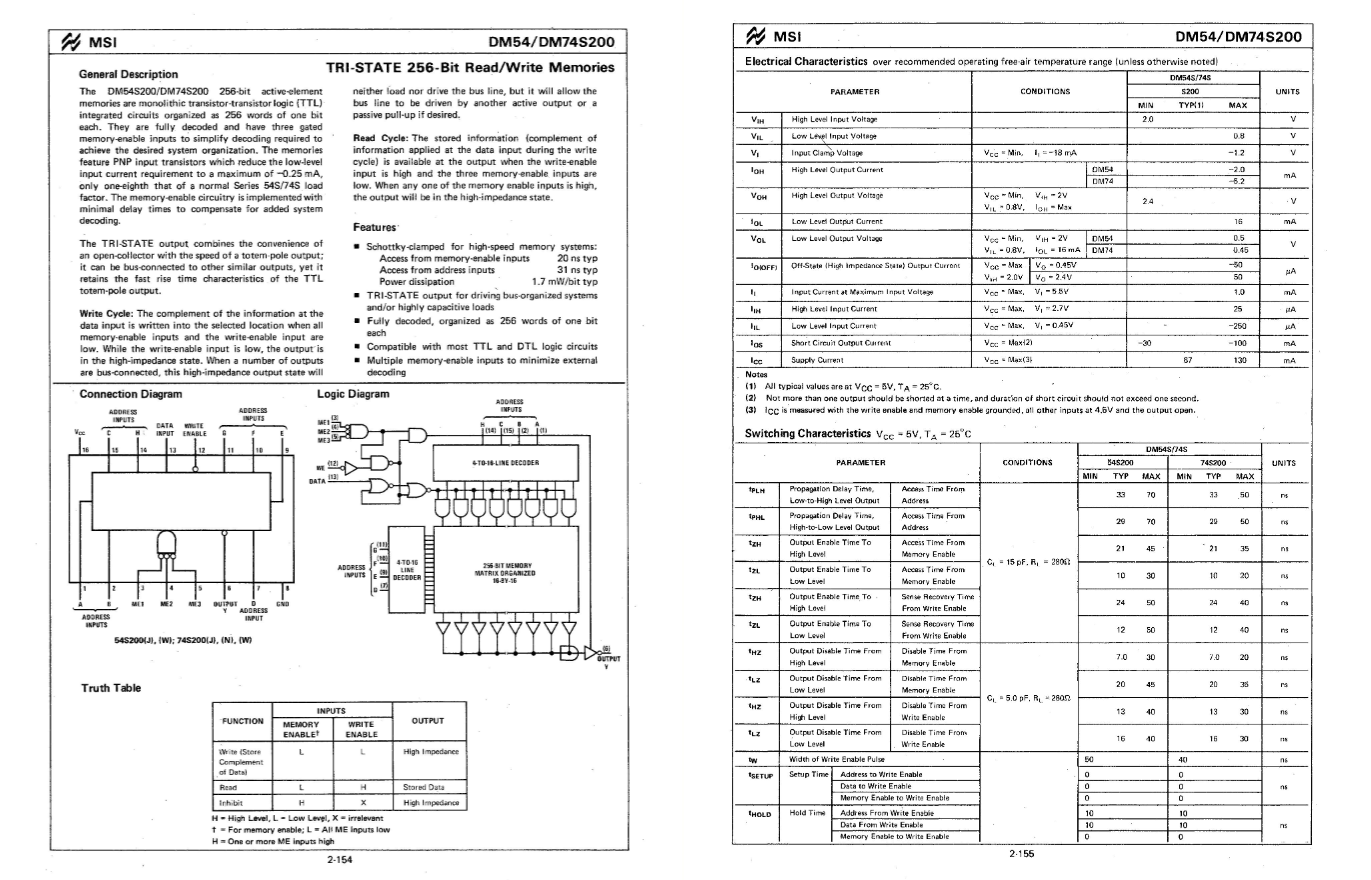

Quote from blitobyte on June 17, 2024, 4:32 pmThere's a 74XX200 256-Bit Random Access Memory on the list of IC 74's but I cannot find its datasheet. Actually I've found nothing, about it and GPT says there's no such an IC. What am I doing wrong?

Quote from Fizik_S on June 17, 2024, 5:35 pmhttps://archive.org/details/bitsavers_nationaldaTTLDatabook_42712617/page/n299/mode/2up?view=theater
