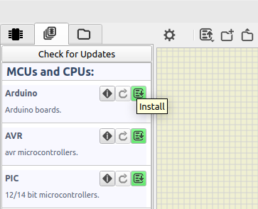

by the way: you can use Arduinos in version 2.0.0, but you need to install it before:
It is fixed in SimulIDE_1.1.0-SR2 (tested in Linux and Windows).
I think the bug is in 1.1.0-SR1 but not SR2.
