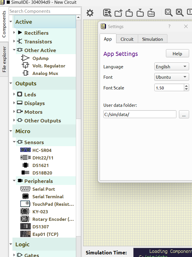

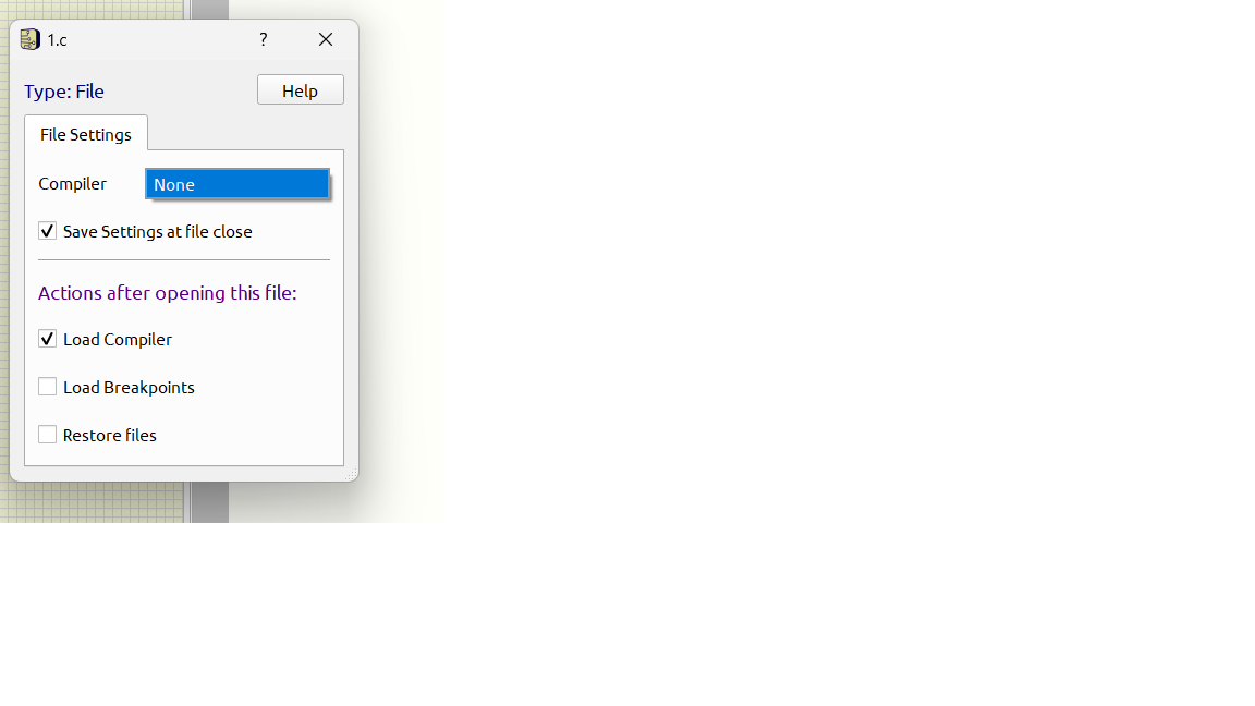

there is no compile menus. i can't choice.
doo@doo
13 Posts
1,042 Posts
#2 · May 2, 2024, 5:40 am
Quote from arcachofo on May 2, 2024, 5:40 amHi.
You need to add the compilers you want to your user data folder using the same structure than Simulide/data in previous versions.
Configuration files for the Editor/Compiler/debugger should be in "codeeditor" folder:
User_data_folder/codeditor/compilers/compilers
User_data_folder/codeditor/compilers/assemblers
User_data_folder/codeditor/syntax
