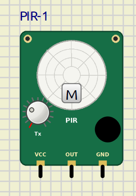

Quote from amiarobot on October 5, 2026, 8:51 amHi @patrick74
I made one to simplify the schematics for my high school students. It's nicer to have a real component, and it makes things easier to read for exams.
Let me know if you're still looking for one.
Hi @patrick74

Quote from amiarobot on October 16, 2026, 3:21 pm@patrick74
Here is a zip with the PIR sensor files. You can decompress them and follow the instructions in the "read_me" file to add the PIR sensor to your SimulIDE installation. Simply copy and paste the various files into the appropriate folders.
