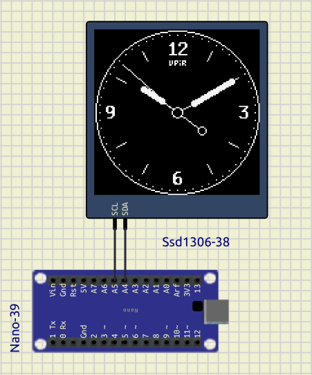

Quote from arcachofo on September 17, 2024, 2:37 pmHi again.
I fixed some issues and it seems to be working now.
At least this example using U8g2lib library is working (uncheck "Rotate" property):
Hi again.
