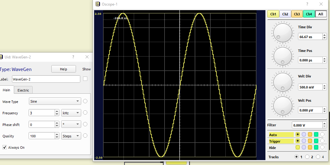

Quote from timathis on October 10, 2025, 6:16 pm
The oscope is one of the more important instruments for circuit simulation.
I would like to see more real life scope controls:
For instance is the time position variable a replacement for the standard horizontal position?
Is the volt position control the vertical position or ground reference control?
The scope also seems to autorange to some non standard voltage setting like 795 mV per division. I would like to see the standard 1-2-5-10-20-50 ranges and 1-2-5-10-20 mS type of choices.
Also a dc and ac input setting would be nice.
If I try to set the time voltage to 1 volt in the all channels setting as soon as I activate the circuit it switches to some new setting.
Is there something about using the scope I'm not seeing?

Quote from arcachofo on October 10, 2025, 6:23 pmMost probably you have "Auto" activated for some channel.
Here you have some information about Oscilloscope:
https://simulide.com/p/oscilloscope/
