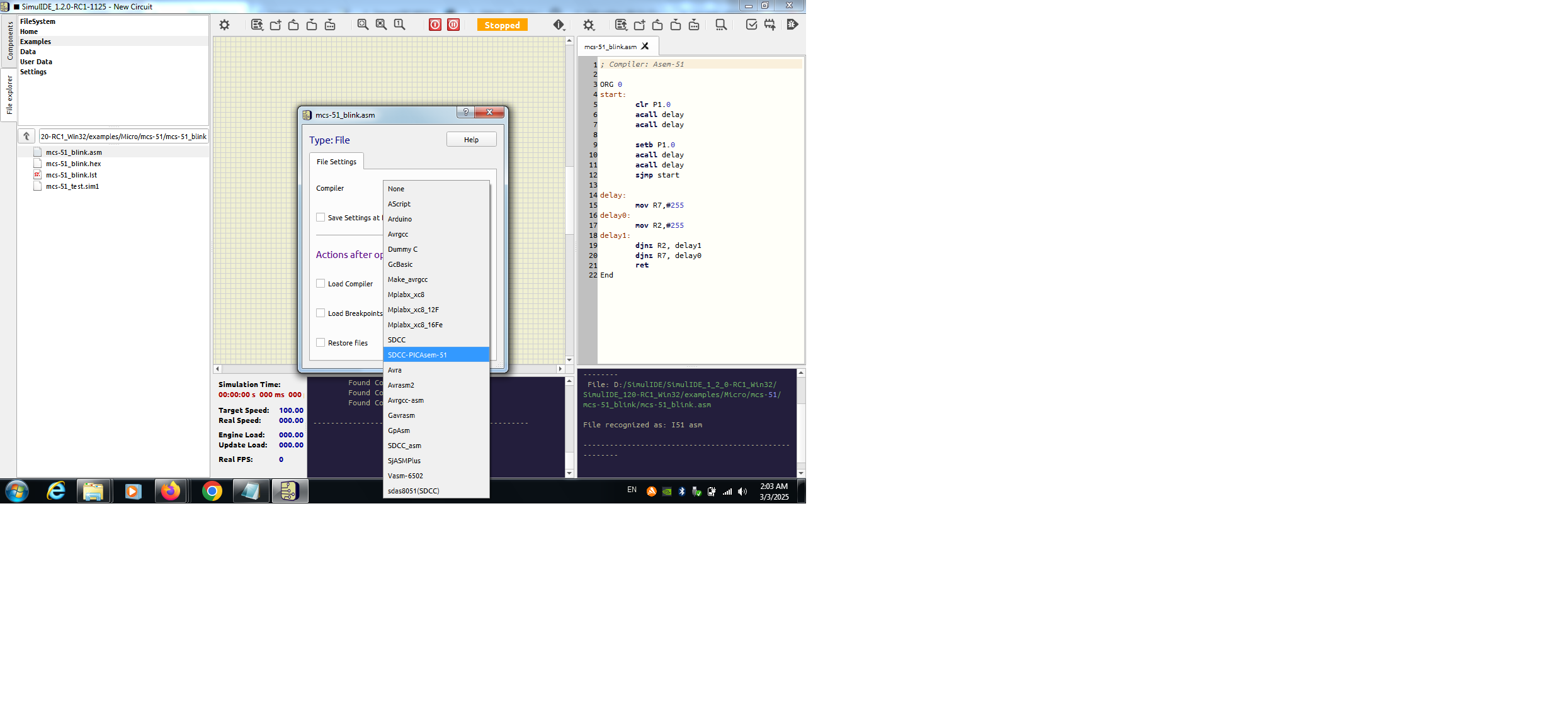

dear my freind
i can't compile SDCC for PIC like befor look at the picture with the version 1.2.0 RC1
at file setting --> compiler the SDCC-PICAsem51 at the same line
can you please fix this
many thanks
MedTronic
dear my freind
many thanks
MedTronic
Quote from MedTronic on March 4, 2025, 8:53 am@arcachofo where are you sir
Quote from arcachofo on March 4, 2025, 10:03 amHi Medtronic.
Thanks for reporting, I will fix it as soon as possible.
As a workaround you can change the name of the compiler in a way that it is before in the list.
For example edit file data/codeeditor/compilers/compilers/sdcc-PIC.xml and change to: name="0_SDCC-PIC"<compiler name="0_SDCC-PIC" type="sdcc" buildPath="build" >

Quote from MedTronic on March 4, 2025, 3:43 pmi test what you say .... the compiler it appear but can't copmpile as befor .... the compiler run but cat' generate a hex file
thanks in adavnced
thanks in adavnced
Quote from arcachofo on March 6, 2025, 1:48 pmI think the best you can do is to move the sdcc-PIC.xml that was working for you to your "user data folder":
your_data_folder/codeeditor/compilers/compilers/sdcc-PIC.xml
