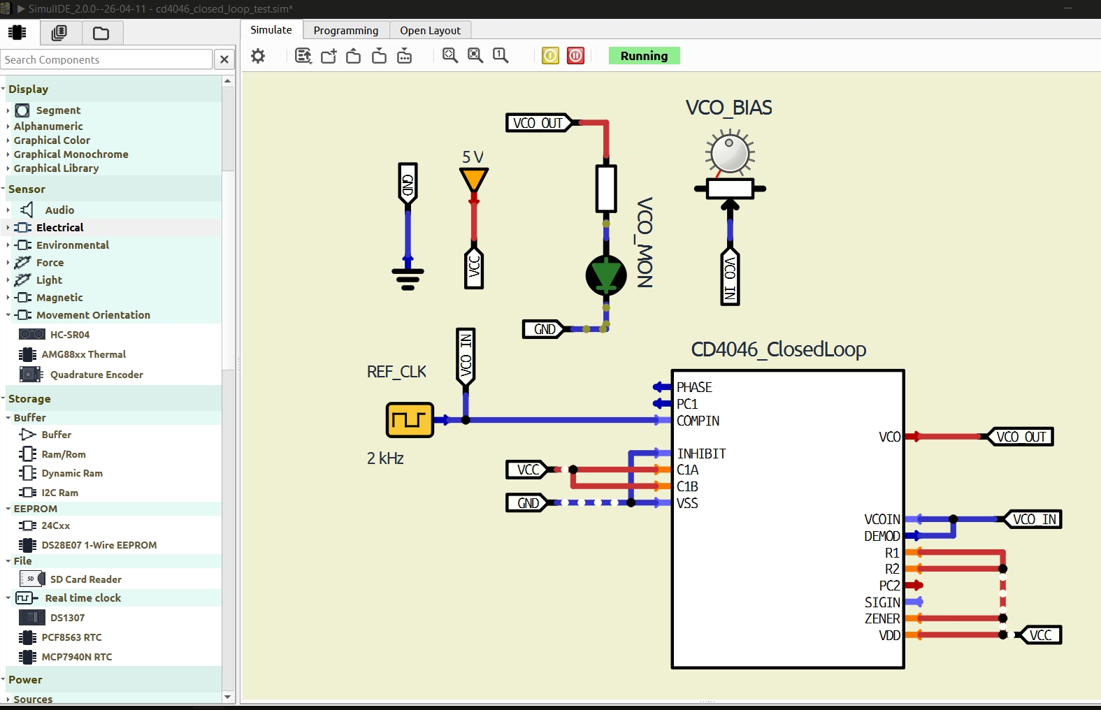

Quote from Mistral on April 12, 2026, 2:26 am@firefox66
Yes, indeed, that is the one. Very well made, thank you. It has been quite a while since I looked into that chip and moved my attention elsewhere but certainly I will come across this PLL-subject once more.
This is its datasheet, from Fairchild because it is much better readable than from TI.
CD4046 DatasheetI saw something new in your simulation, first of all the version which seems to be 2.0.0 while I have 1.1.0-SR2 and as far as I know that is the most recent version. Another thing is your clock with an unconnected VCO_Bias potentiometer attached to it?

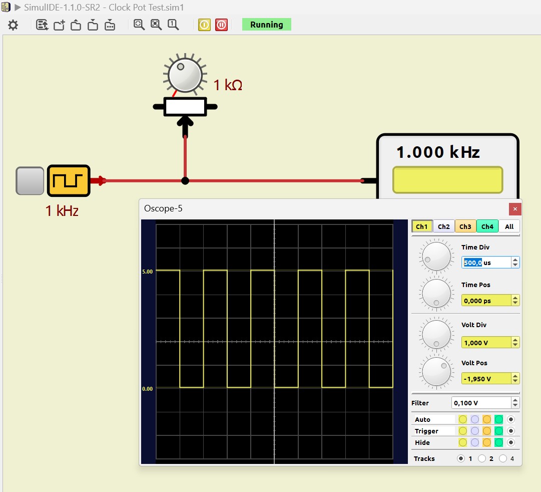

I tried it but nothing changes when I turn the pot:
@firefox66
CD4046 Datasheet
