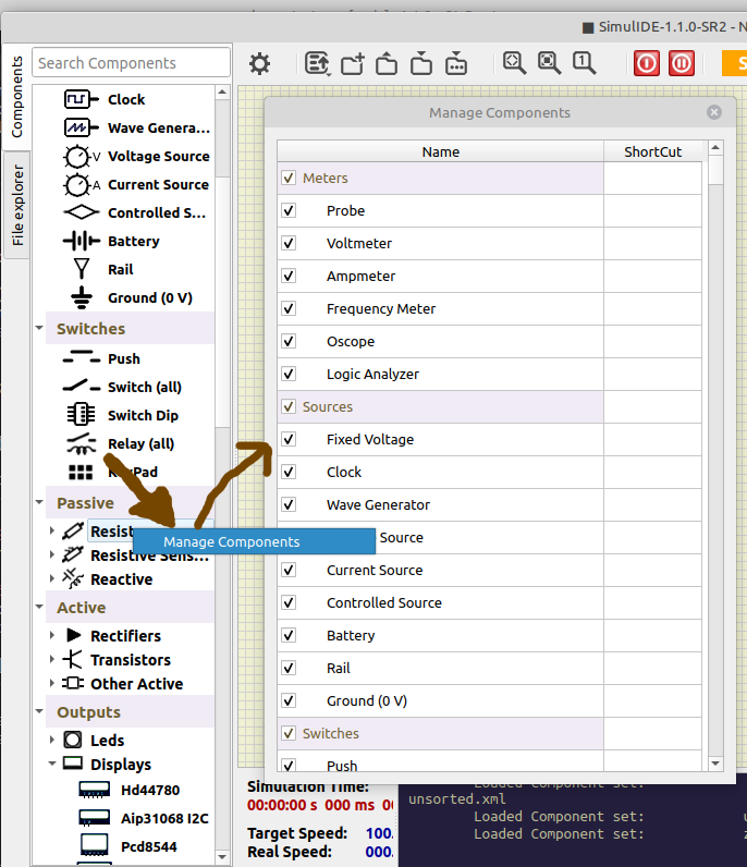

Quote from arcachofo on April 18, 2026, 6:06 pmHi.
Most probably components are hidden.
Right-click on any part of the component list and select "Manage Components".
There you you can show/hide components or whole categories.https://simulide.com/p/manage-components/
