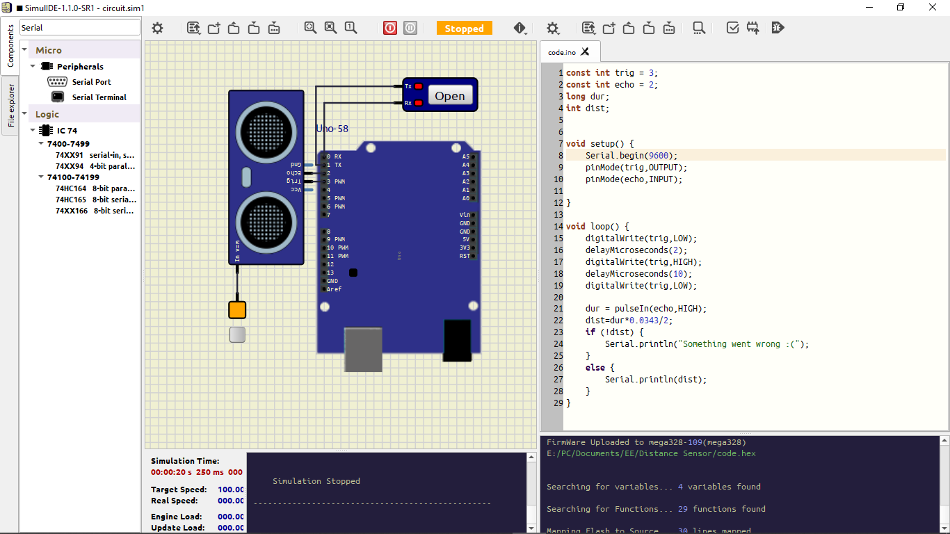

Quote from gamesofaslandev on June 19, 2025, 3:39 ami cant figure out why isnt the distance sensor doing anything the terminal is empty the simulator im using is simulide heres the circuit:

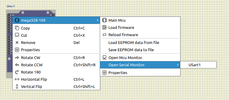

Quote from arcachofo on June 19, 2025, 5:24 amHi.
You should connect Tx to Rx and Rx to Tx.
Or don't use a Serial Terminal and just Right-click on Arduino an select: Open Serial Monitor -> USart1
