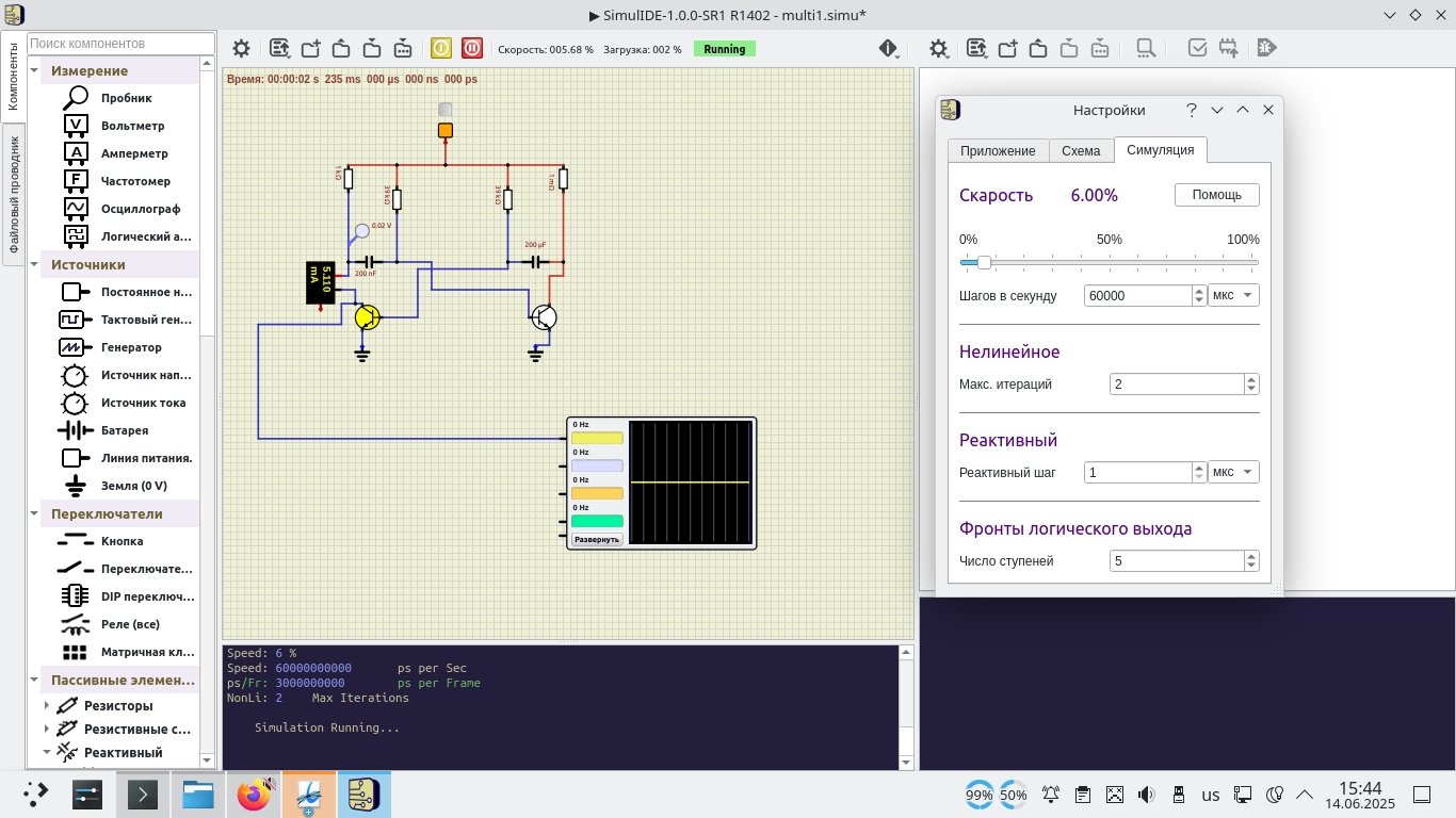

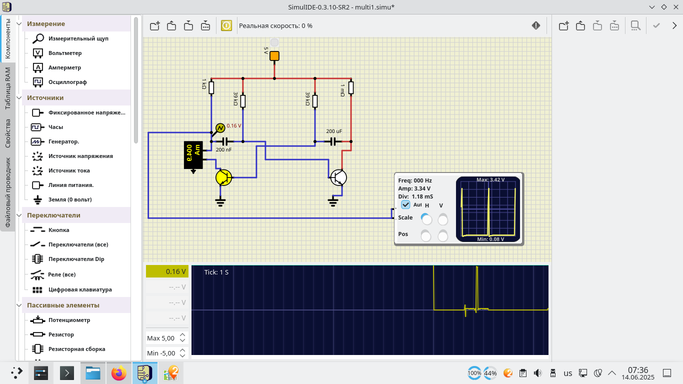

It seems that the accuracy of calculations in the latest versions has decreased compared to version 0.3.10-SR2.
As you can see, the symmetrical multivibrator produces some fluctuations on version 0.3.10-SR2 and just spikes on version 1.0.0-SR1. We need to somehow return some calculation methods from the old version, since they give true behavior.
