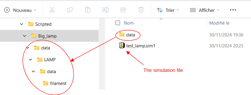

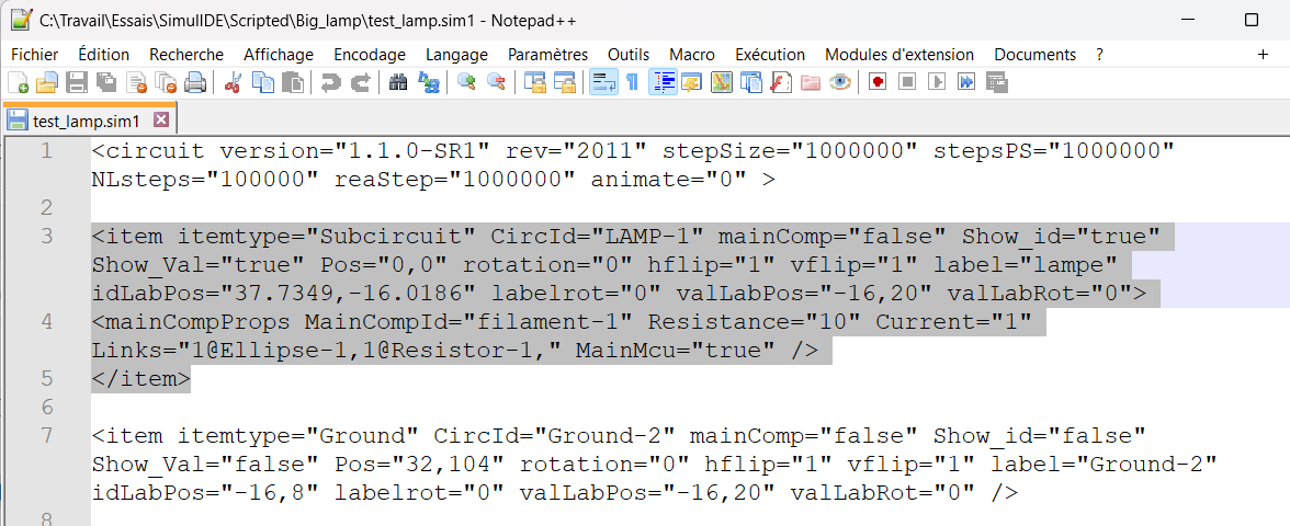

Uploaded files:Quote from LWT98709 on December 1, 2024, 3:50 pmYou can leave the model in the sub folder "data" aside the simulation file. Your project will be portable. But, have to edit your .sim1 as a text file to include the model, or make a copy / paste from an existing simulation file.
Or you can add it to your SimulIDE folder. Have to edit your .xml file.

Quote from LWT98709 on December 1, 2024, 4:33 pmI am not a specialist in using libraries in SimulIDE. I learned using information I could find here and there. In addition, I am not an English speaker.
For this project, I imitated deFran's projects.
With deFran's other projects, the models are placed in a "data" subdirectory relative to the simulation file. The models in "data" can in turn use other models always in relative "data" subdirectories.The problem with this operation is that the models are not visible from the menu. It is necessary to edit the simulation file as a text file to add the new model. You must add an <item> tag with the CircId value starting with the model name (example: CircId="LAMP-1").
If you want to avoid editing the simulation file as a text file, you can copy and paste from a file that already has the model.

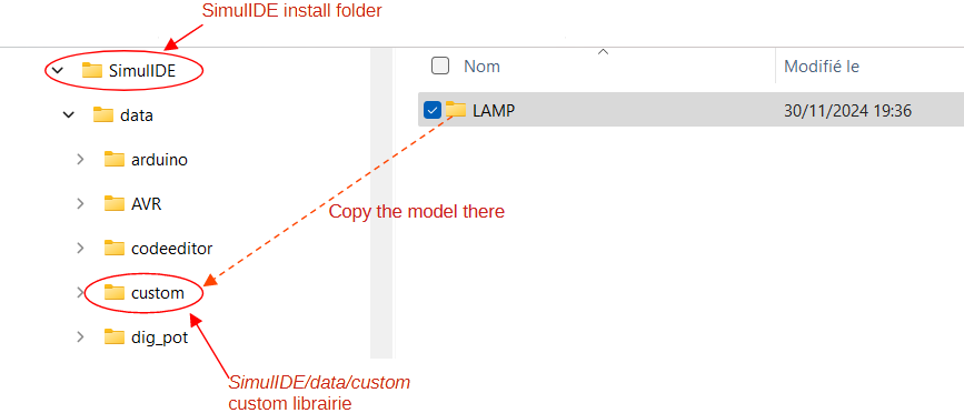

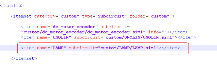

Quote from LWT98709 on December 1, 2024, 4:55 pmIf you absolutely want the model to appear in the SimulIDE menu. You have to follow the procedure of one of arcachofo's videos (I don't have the link ...).
The principle is to copy the "LAMP" folder (or the "data/LAMP" folder in my zip file) to the "SimulIDE/data/custom/LAMP" directory (assuming that "SimulIDE" is your SimulIDE software installation directory). Then, edit the "SimulIDE/data/custom.xml" file and add in the "custom" category, type "Subcircuit".I understand that it is complicated. The software is still in development. The "user friendly" model addition features are not yet implemented. If you want to exploit the enormous potential of the software, you need a little manipulation.
