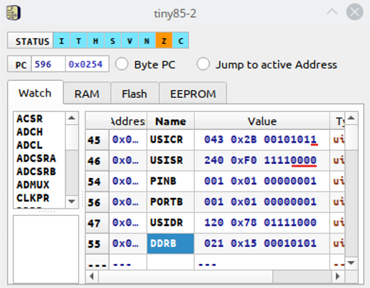

Quote from CourN on December 21, 2023, 12:57 pmLooks like USI not working properly at Attiny85. When I set USITC high it stuck (besides i can't set it back to 0 manually) and USISR not count. I even try downloaded hardware I2C libraries and get the same behaviour.void i2c_clock(unsigned char mask) { PORTB &= ~(1<<PIN_SCL); USISR = mask; do { _delay_us(WL); USICR |= (1<<USITC); while ((PINB&(1<<PIN_SCL))); _delay_us(WS); USICR |= (1<<USITC); } while (!(USISR&(1<<USIOIF))); _delay_us(WL); USIDR = 0xFF; }
USISR = mask;
do
_delay_us(WL);
_delay_us(WS);
_delay_us(WL);
USIDR = 0xFF;
v.1.1.0-RC0 R1909 OS:Debian 12
