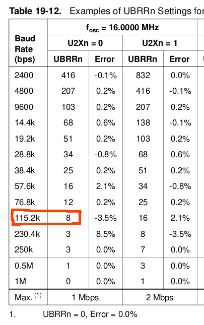

This formula: UBRR0 = (F_CPU / (BAUD * 16)) - 1 has an error, it is a truncated integer.
In this case the actual value is 7.68, so it should be rounded to 8.In the datasheet you can see the example value for 16 MHz, 115200 is 8:
Serial Terminal does not have any limitations other that the minimum time in the simulation = 1ps.
So theoretically it could run well beyond thouthands of Gbps.
Seems that the problem is in the calculation of UBRR.
