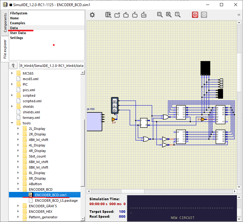

Quote from Fizik_S on November 27, 2024, 10:13 pmHello, KerimF.
The encoder ENCODER_BED and ENCODER_HEX are subcircuits, that is, they are assembled on logical elements and are not a software product. They cannot be pre-set either before the start of stimulation or during a pause. I have slightly changed the encoders and you can install them in the simulator yourself. The description of the installation and the improvements made can be viewed at the link:
https://simulide.com/p/forum/topic/new-subcircuits-for-simulide-v-1-1-0-and-higher/#postid-1610
There is also an archive with two versions of improvements. The encoders themselves are files with the extension "*.sim1". They can be opened in the program. You can also open any other subcircuits. If you wish, you can change any subcircuits or create new ones.
