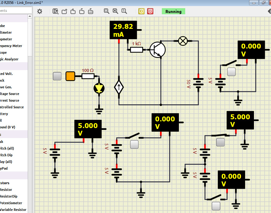

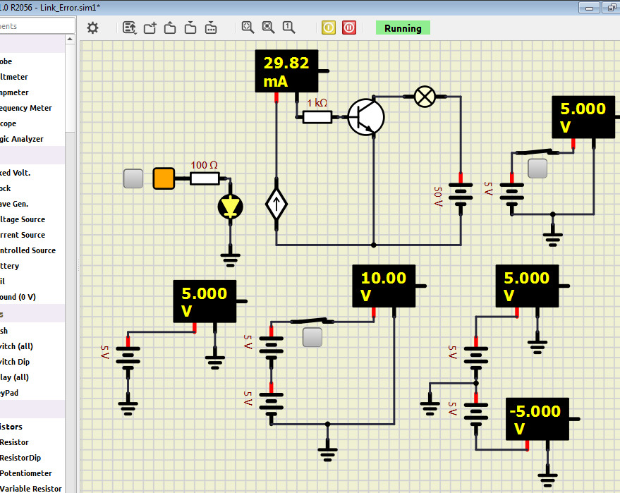

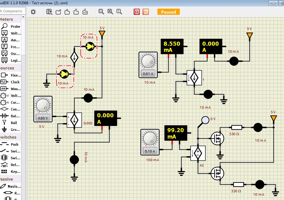

CURRENT SOURCES DO NOT WORK? ? ?
Uploaded files:
Yes, you are right.
Seems that I totally broke current sources.
I will fix it and upload new files.

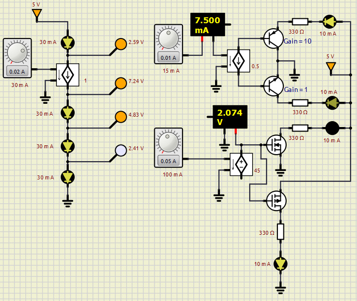

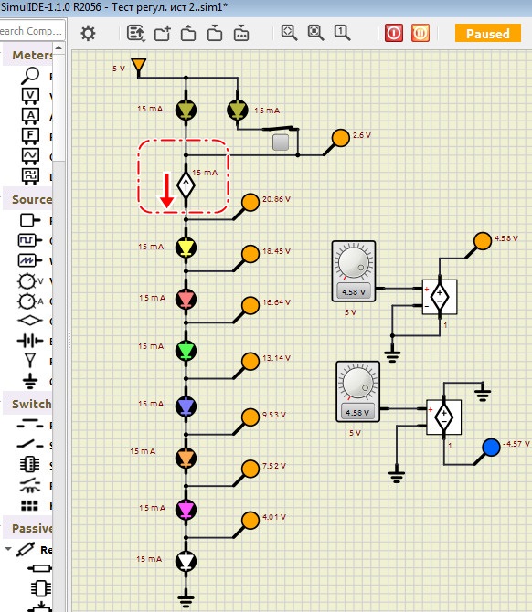

This is how it should be! Working models in 2056
Uploaded files:

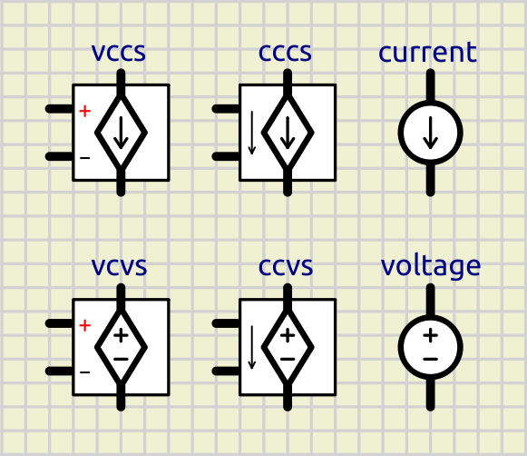

Change ARROW - direction of Current
Uploaded files:
arcachofo has reacted to this post.
arcachofo

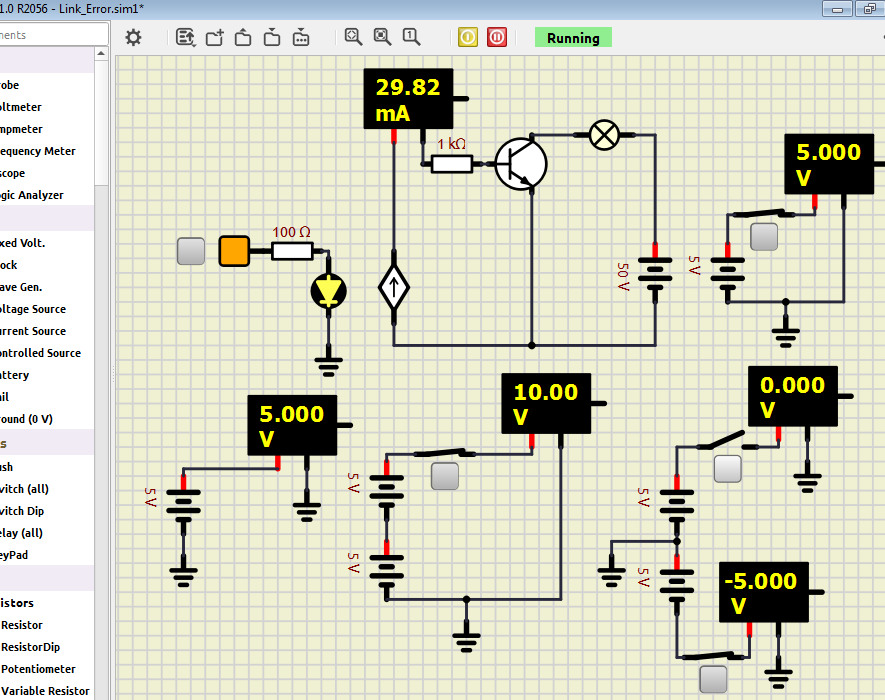

Solved at Rev 2071.

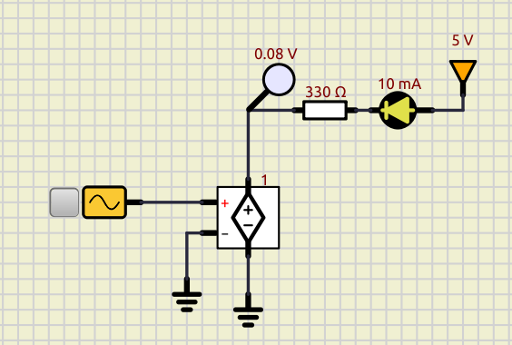

But now the issue reported by Fizic_S is back:
https://simulide.forumotion.com/t550p175-simulide-trunk-tester-builds#8643
I need to create a new model for this component.
The only solution by now is to not connect the control pins with the source pins.
For example use a different ground for each pin:
Also changed the symbol for fixed source (R2073):

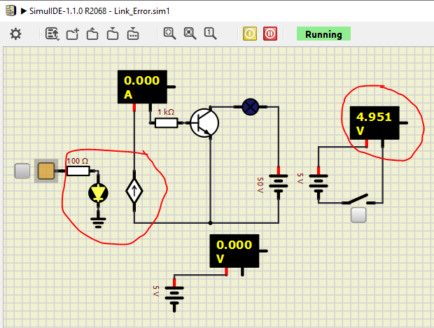

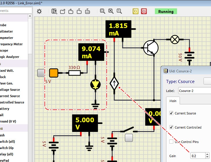

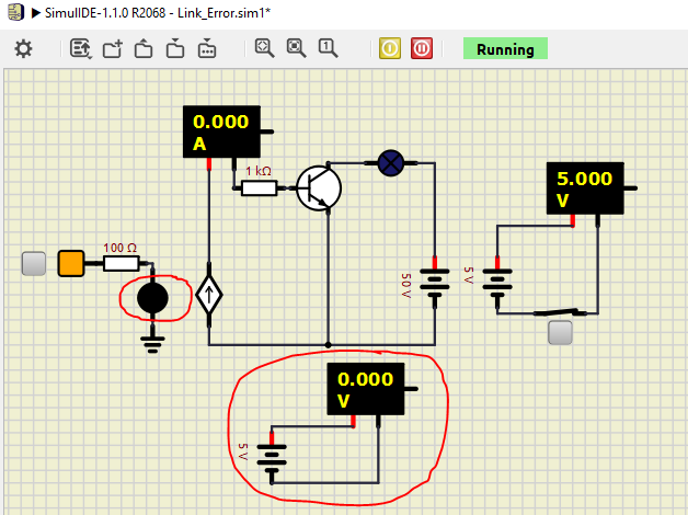

I found errors in version K 2068:
1. The LED and the current source do not communicate with each other.
2. Errors in the battery.

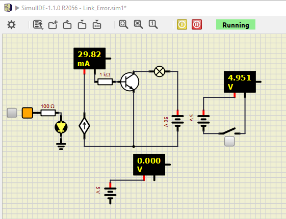

In version K 2056, the linked components work:
Uploaded files:
2056
Uploaded files:
Uploaded files:
Uploaded files:
