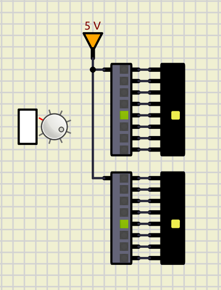

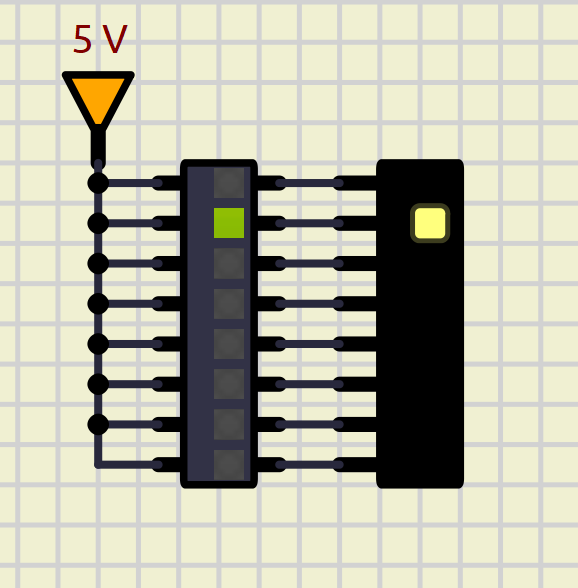

Quote from arcachofo on January 4, 2024, 9:25 pmIt woks fine, thanks.
Nice.
I added a "Common Pin" property to be used with a common source like in your picture.
Also made it "linkable" and made Dial steps configurable.
SO now with a dial you can control several switches.
Also changed the color a bit to differentiate from led bar:
Nice.
