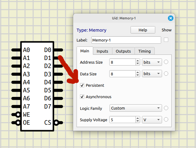

ROM: I would like it to update the data from the file when it changes - each time I have to load it manually

About ROM: Check property "Persistent"

Thank you for your attention. But enabling the checkboxes you specified does not give anything.(
