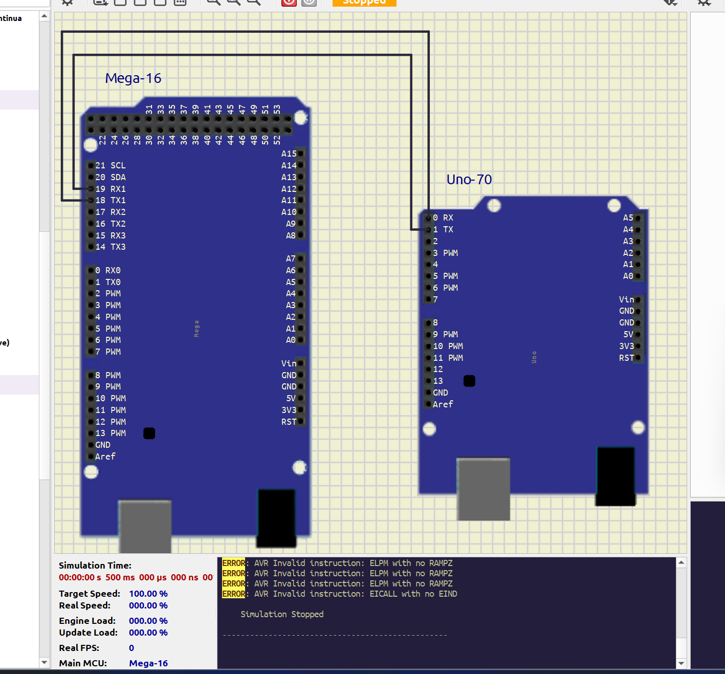

Quote from Giallu on March 29, 2025, 7:28 pmHi to all and thanks in advance.
I'm a newbie and it's sure to be noticeable.
I'm trying to simulate the communication between Arduino as explained in this video:https://youtu.be/jyo1JZN7W6g?si=3r8B3LE1a3IihkDG
Individually the two cards seem to work but if I connect them together,
as soon as I start the program it gives me an error and freezes.
Can someone give me some suggestions to understand what I'm doing wrong?
Thank you VM

Quote from arcachofo on March 30, 2025, 10:02 amHi.
I think you are uploading Mega firmware to Uno.
Load each hex from each Arduino or if you are compiling from the Editor you should choose which board to use:
