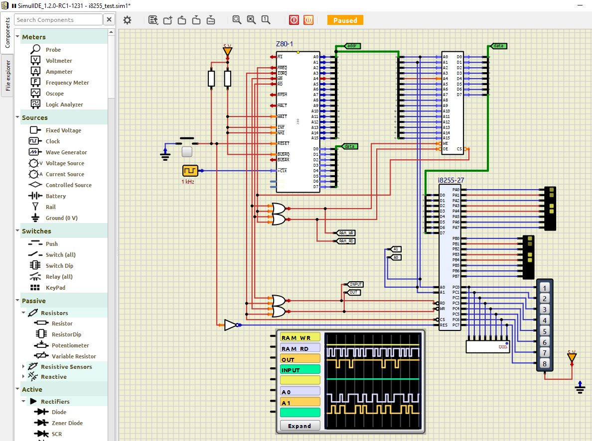

Quote from Fizik_S on June 25, 2025, 8:14 amWhile creating models for Proteus Pro, I came across a curious artifact of the past: a behavioral model for the i8255 built on logical primitives. I decided to adapt it for SimulIDE. I'm sharing the result.
The subcircuit simulates the operation of the PPI i8255 in mode 0 (simple parallel input or output). This is sufficient for most tasks.The subcircuit is designed for SimulIDE 1.2.0. It will not work in earlier versions.
Please test it and point out any errors.Installation:
Extract the contents of the archive to the directory SimulIDE_1.2.0-xxx\data\ICs\
To the file unsorted.xml add a line:<item name="i8255" info="Programmable Peripheral Interface (PPI)" />
Installation:
