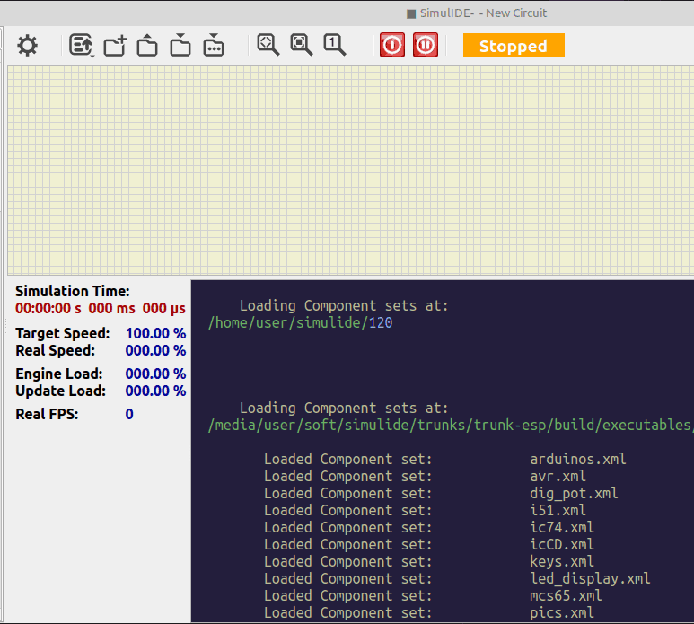

By now I'm just trying to get some basic examples working with Qemu:
Yes, Renode looks very well and is fully controllable, even instruction by instruction I think.
Unfortunately, helping with the code is way above my pay grade, but please let me know if I can help in any way.
Eventually we will need lot of testing, but this will take some time.
Quote from ks-0 on March 28, 2025, 10:22 pmEventually we will need lot of testing, but this will take some time.
I'd be happy to help when it's time for testing.
Again, thank you for working on this, it's already very exciting just to see the ESP32 blinking an LED in Simuilde.
