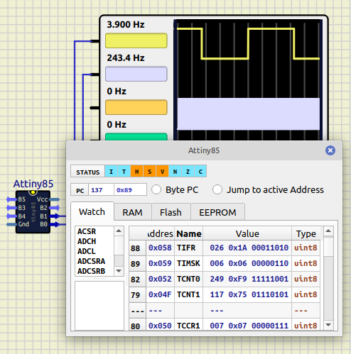

When I use Timer1 for ATTiny85, the counter register TCNT1 is always 0. The same behaviour is observed for Timer0. I checked the same firmware hex in Proteus, and everything worked properly. Could someone help me fix this issue? It would be helpful for debugging. Thank you!

I guess I've found a workaround. If you set up the timer and use an empty loop, then TCNT1 is empty. But if you read TCNT1 value periodically, then all works as expected;

Thanks, now I see what is the problem.

I think this should be solved in last tester build for 1.1.0:
https://simulide.com/p/testers/
