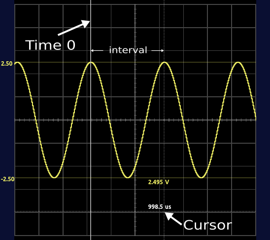

Is there a way to calc intervals in osciloscope? Something like adding two points and seeing the difference between them.

You can see the time respect to "time 0" in the mouse cursor when you move it into the Oscilloscope screen.
The "time 0" line is in the middle of the screen by default.
You can set the reference (time 0) to any point in the screen with mouse middle button.
Quote from jcbritobr on March 31, 2024, 11:30 pmHello. Good evening. Thank you. Helpe me a lot. Its not so precise to do some analysis, but it works. I will use qucs-s if I need more precision.
