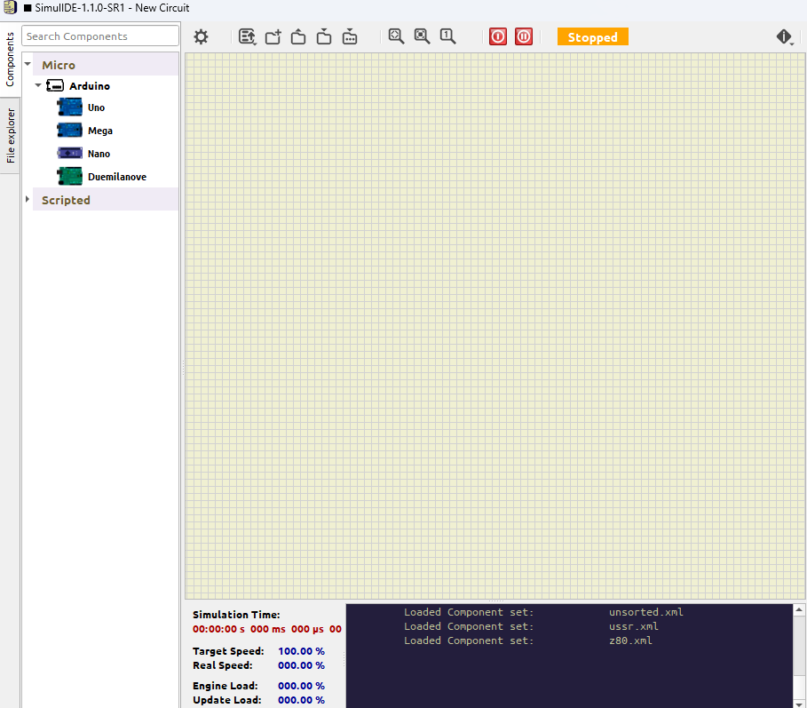

Quote from Galban on October 14, 2025, 8:00 pmHi, I just downloaded the 1.0.0 but It had no arduino, I changed settings and then I was able to use the arduino, but all the other components went missing

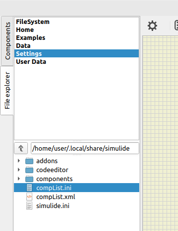

Quote from arcachofo on October 14, 2025, 10:07 pmHi.
I think you can fix it deleting the file compList.ini
The location of that file depends on your system, you can find it in File Explorer->settings:
