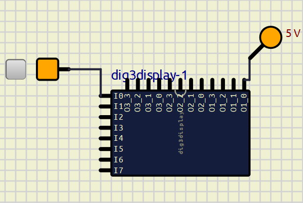

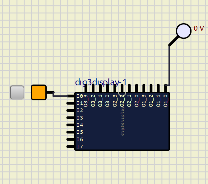

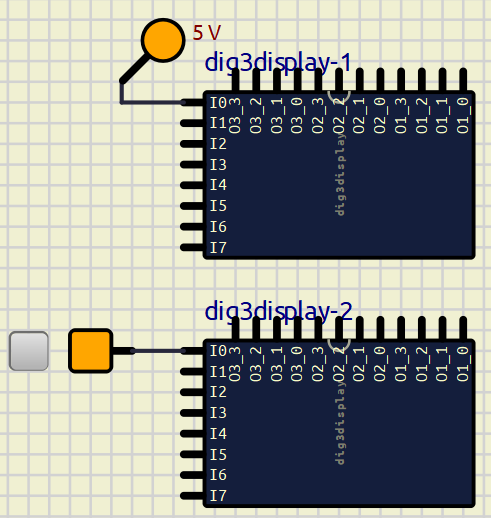

Incorrect connection of pins of two instances of custom package.
Quote from artemUserovich on January 12, 2025, 8:24 pmIn file dig3display_test.sim1 pins with similar labels (ids) from two different instances are connected for some reason.
Module is included by adding in Simulide/data/custom.xml and package dig3display and deps
Quote from arcachofo on January 13, 2025, 10:08 amHi, thanks for reporting.
I found that the problem happens with 2 levels of nesting in subcircuits.
I think I have it solved, if you want to help testing the solution let me know which OS are you using and I will build executables for you to test.
