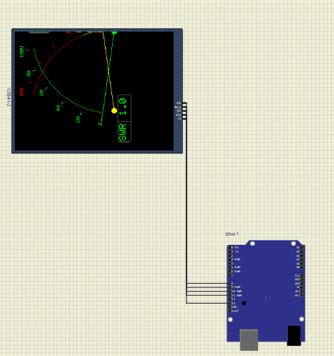

tft.setRotation(1)
The TFT screen is set to rotate 90 degrees, but the simulation remains unchanged. Could it be that inverted display is not possible?
tft.setRotation(1)

Quote from arcachofo on July 3, 2025, 12:37 pmThe related command is implemented now (not much testing).
You can try when new builds are uploaded at:
https://simulide.com/p/testers/
