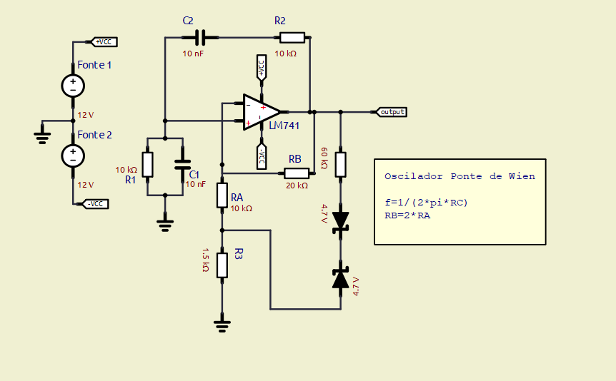

How to simulate a WIEN BRIDGE?
Quote from MadDog on October 2, 2024, 11:23 pmHow to simulate a WIEN BRIDGE?
The wave does not appear on the oscilloscope.
I believe that carrying out a transitional period simulation would solve the problem.
How to perform a transitional period simulation in simmulIDE?
