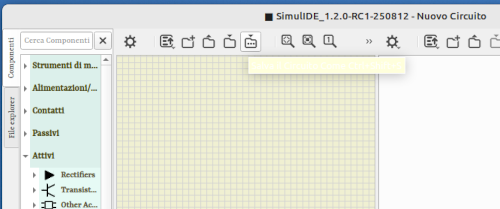

Quote from percoco2000 on August 12, 2025, 4:26 pmHi to everyone, i'm Gregorio from Italy.
First of all, thank you for all the effort in this simulator, find it very useful.
Compiled last develop version (2.0) work ok, but i've this annoing bug:
The text in the menu tooltip is empty. No compilation warnings or error, an no complaining when launching from terminal.
Attached an image that shows the bug. Out of this the simulator works as expected
Any suggestion?
Any suggestion?
Quote from arcachofo on August 12, 2025, 6:17 pmHi that does not seem to include the last commits.
In any case the problem is probably about the translation.
Quote from percoco2000 on August 13, 2025, 2:26 pmIt doesn't include the last commit, because i was looking for a version compatible with 1.1.
But the same happens with latest 2.0.
Can you be more explicit about "translation" problems? I tied to change the language from the setting interface, but doesn't change.
Quote from percoco2000 on August 13, 2025, 6:06 pmI mean, doesn't solve the problem
But if i download the binary it works as expected
Quote from percoco2000 on October 12, 2025, 6:52 pmFind a solution thanks to chatgpt....
If i launch the compiled binary with the -style=fusion the text appear again. I suppose the default style has the same color for foreground and background
