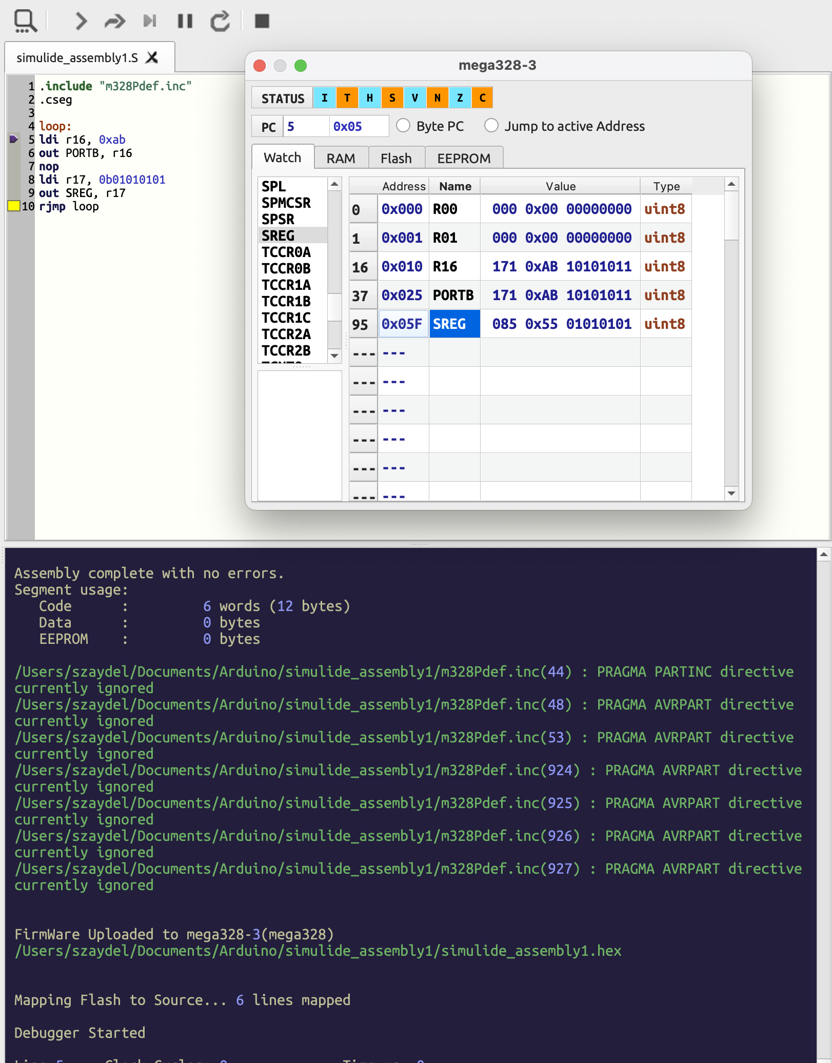

Quote from szaydel on November 10, 2024, 5:39 pmThe other thing I am noticing is that I can click Run To Breakpoint and that seems to work, but the arrow icon on the left hand side does not appear to advance. Yet, as can be seen from the screenshot, the values in the
R16
andPORTB
are indeed updated. You can see that I added a nonsense modification of theSREG
register and it is reflected in the MCU monitor. Yet, at the same time the arrow on left hand side is still pointing to line 5. Clearly the MCU advanced past line 5, but the arrow does not appear to be moving. This may be an unrelated issue.
The other thing I am noticing is that I can click Run To Breakpoint and that seems to work, but the arrow icon on the left hand side does not appear to advance. Yet, as can be seen from the screenshot, the values in the R16
and PORTB
are indeed updated. You can see that I added a nonsense modification of the SREG
