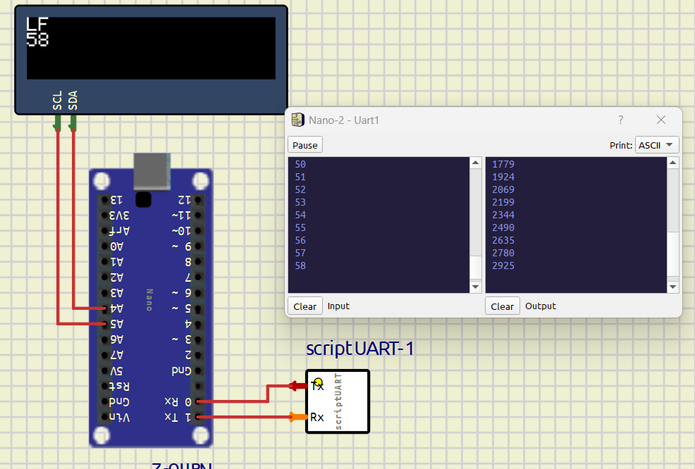

Quote from LWT98709 on March 27, 2025, 5:27 pmSomewhere in this forum arcachofo has posted some templates to work with communication device (TWI, TCP, I2C, and UART).
I've done some example circuit that I join here.
Works with version 1.2.0 RC1 rev 1125.
