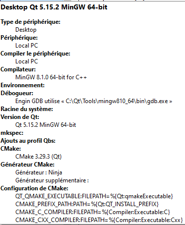

After some update, the simulIDE has been build on windows.
Necessary Adjustments for Compiling SimuIDE on Windows

Target file : SimulIDE.prj
