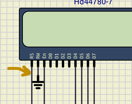

It will be solved for next tester build: https://simulide.com/p/testers/As a side note, you need to actually connect ground to LCD RW Pin:
Thanks for reporting.
The crash is because a bug in 16F628 comparator 1 mode 6.
Quote from electr0n on August 18, 2025, 10:34 amHi,
Thanks for your quick reply.
I added the missing ground connection. Can this be automatically done when two items pins touch ?
