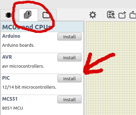

Quote from arcachofo on August 31, 2025, 2:10 pmHi.
Version 2.0.0 doesn't come with Microcontrollers or subcircuits installed, you need to install those which you want to use:
