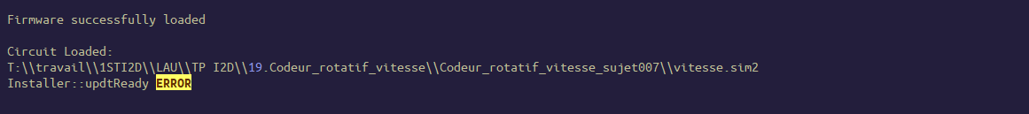

Quote from LWT98709 on March 2, 2026, 5:19 pmHello,
With 2.0.0, in Windows, it seems that when open a .sim2 file from network drive, there is a "installer updtready error".
The installer tab is also empty.
But, simulation still works.
It happens when an file association is made between ".sim2" and "simulide.exe".
No such error when open from local drive C: or D:It seems that the error happens when there are scripted components.
No such problem if you open simulide first, than open the file from inside simulide.

Uploaded files:Quote from arcachofo on March 2, 2026, 10:24 pmI think that is just a timeout.
SimulIDE tries to get last updates from server, it takes too long and it gives up.
This still needs quite a bit of work.
