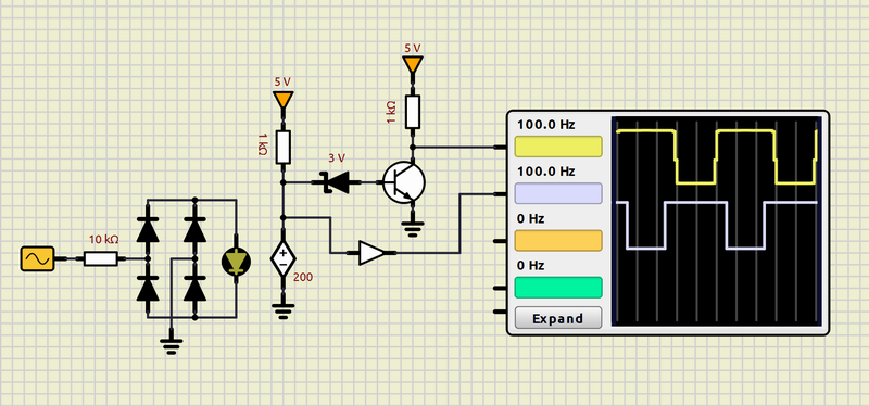

Quote from KerimF on March 10, 2024, 9:38 pmQuote from Defran on March 10, 2024, 9:14 pmHere is another idea to get the edges of the signal more vertical.
You did well. Thank you.
But, you know, adding a transistor increases the cost of production.

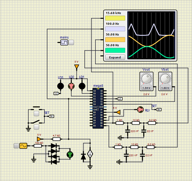

Quote from KerimF on March 11, 2024, 10:39 amSorry, I had to upload my work since I couldn’t discover the root of the problem.
As you will see on the uploaded schematic, a triangular wave generator (turned on) is connected to INT0 pin.
After running the code, LED2 will start blinking (turning on and off) to signal the presence of the mains voltage. Then, after a while, the MCU stops generating the two sine waves.
And by deactivating the triangular wave generator, the MCU, also after a while, resumes outputting the sine waves.Now, the debugger needs to be stopped in order to change the schematic.
First, the connection between the triangular wave generator and the INT0 pin is removed. Then the controlled source will be connected as shown on the photo above (uploaded previously).
By running again the code, LED2 stays in the on state, as if no signal is present at INT0 pin.
For instance, at line 1073 of the code, the state of INTF0 flag is checked continuously (since the interrupt routine of INT0 is disabled). And at line 543, MCUCR is set for the falling edge mode.Thank you.
