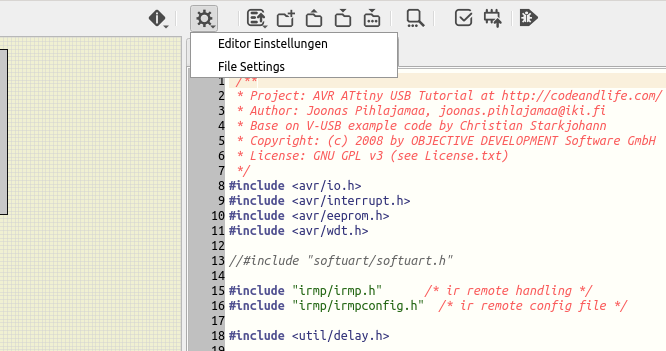

Quote from steinm on January 30, 2024, 3:15 pmMaybe a dump question. How does simulide determine if AVR-GCC is installed? I have it installed but it still isn't selectable in the compiler settings. Actually, it doesn't even show the compiler settings menu item when a .c file is loaded.
In 1.1.0 you select the compiler in File Settings.
Then you can configure Compiler Settings.
