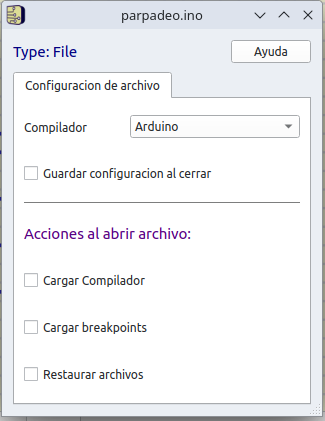

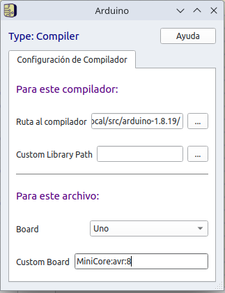

Quote from Lazlo_lozla on November 26, 2024, 1:18 pm
Adjust the initial settings of SimulIDE:
