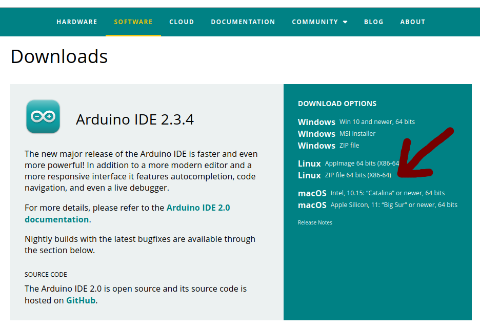

Quote from arcachofo on January 4, 2025, 8:22 pmQuote from vcastillo on January 4, 2025, 6:44 pmI have the same problem.
Which path to put in the "compiler path" when Arduino is running from an AppImage file.
Thanks for the helpHi. To use Arduino from Simulide you should use the files downloaded from official Arduino page (not the AppImage):
Thanks for the help
