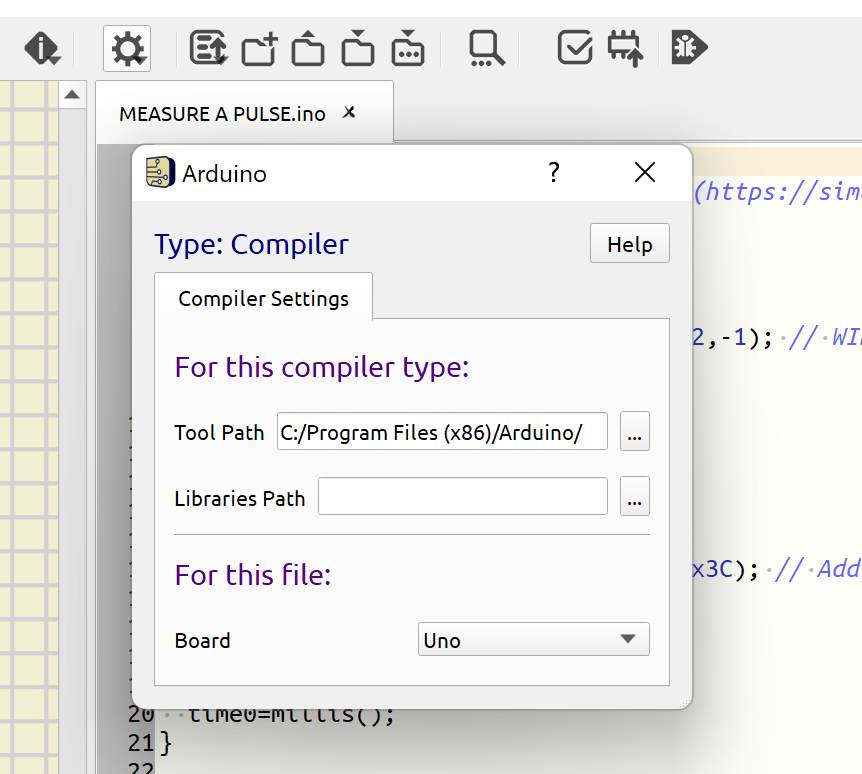

Quote from Defran on January 26, 2024, 9:36 amFor Windows 11 and Arduino IDE 1.8.1.9:
For Windows 11 and Arduino IDE 2.2.1:
