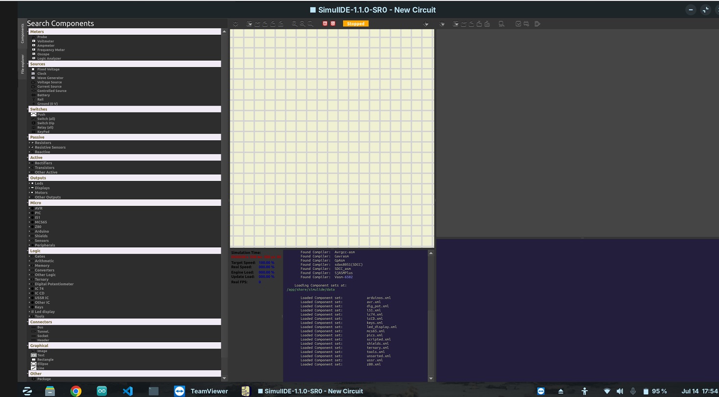

Quote from marvin on July 14, 2024, 7:58 amI have installed Simulide on a 4K screen laptop running ubuntu (zorin)
The app font scaling is set to 2.0 and is totally unusable. The fonts are so small they can not be read.
Is there a way to make them bigger?
