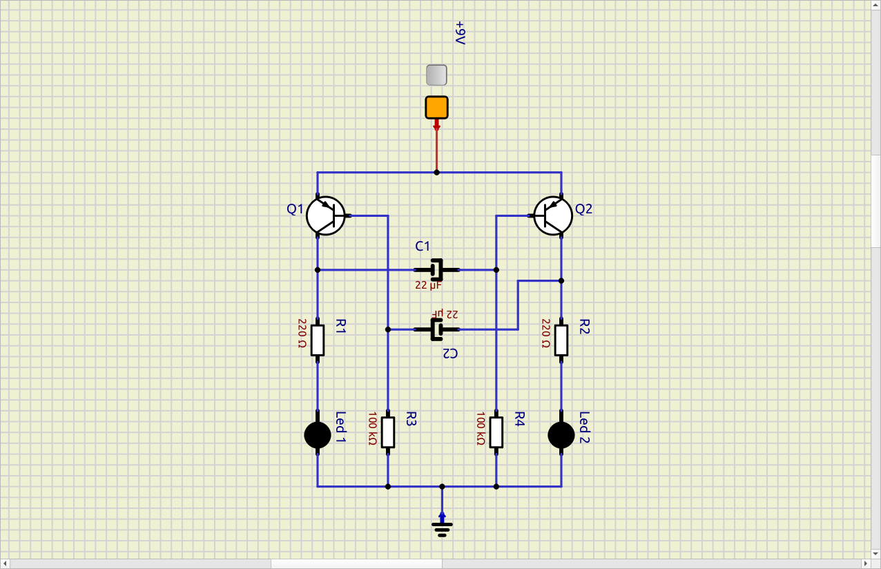

Quote from Azathoth on May 6, 2025, 7:11 pmHi,
This is my first working creation, it is an alternating LED flasher from page 200 of the Encyclopedia of Electronic Circuits, volume 3.
The description reads, The alternating LED flasher is simply a two transistor oscillator with LEDs connected to the collector of each transistor, so that they light in time with the circuit's oscillations.
