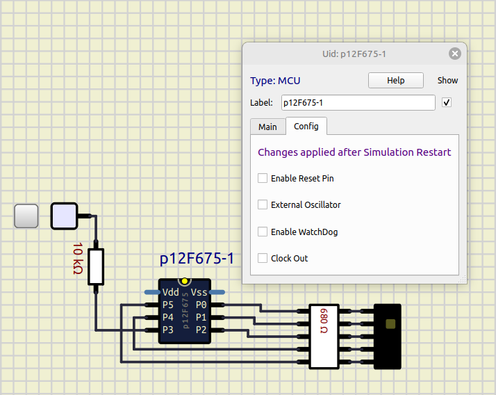

Quote from percoco2000 on October 14, 2025, 9:05 amHi again.. How is the MCLR handled in this micro? Even if i disable it in the config, the simulation still behave as if it was active, so a pullup resistor is needed, even if the datasheet of the micro says that when MCLR is disabled, it is internally pulled up, and the pin is available as input.
Attached an example to test.

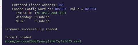

Uploaded files:Quote from percoco2000 on October 14, 2025, 1:50 pmI did it. Reloaded the hex too. In the info window i can see MCLR disabled, but if i dont put the pin at HIGH level, the program isn't executed
Quote from percoco2000 on October 14, 2025, 3:10 pmMy fault. I didn't check the CONFIG tab. I thought it was enough disable it in the hex config.
More than this, in the info window there was a clear message.....
